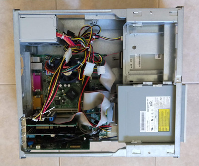

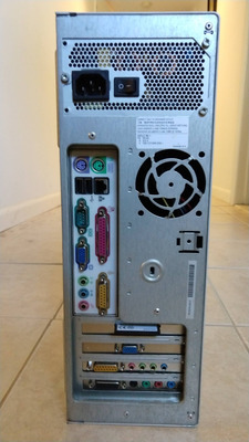

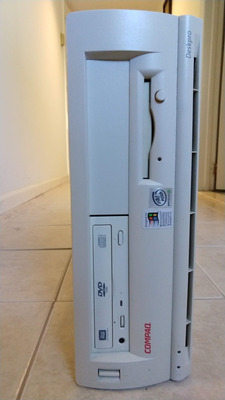

So I decided to start over. I wanted to keep the mATX case and was trying to decide between a Slot 1 and a Super Socket 7 motherboard when @kolderman convinced me to go in for a Socket 370 motherboard with a VIA C3 CPU instead. Trying to keep costs to a tight budget, I purchased a few components with a focus on compatibility vs price, and built the new retro DOS PC with the following specs:

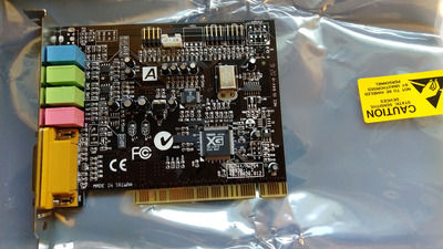

  • Audio: AOpen Cobra AW744L II [YMF744]

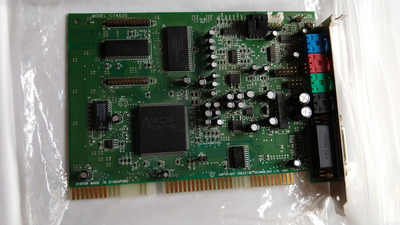

  • Audio: Sound Blaster AWE64 [CT4520]

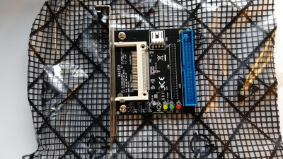

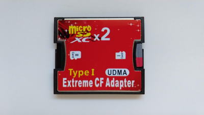

  • HDD: Syba CF to IDE Adapter + CF to SDCARD Adapter + 64GB MicroSD

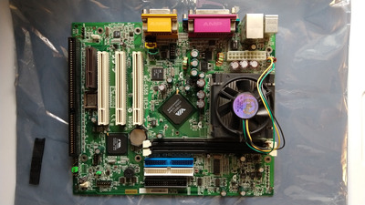

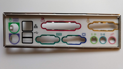

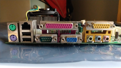

I want to talk a little bit about the motherboard. My requirements were that it had to be mATX, Socket 370, support VIA C3 CPUs, and have an ISA slot. The MSI MS-6368 (manual) is one of the very few does all that, plus it comes with USB, Ethernet, and a Gameport. The VIA PLE133T (VT8601T + VT686B) chipset supports DDMA, and comes with integrated Trident Blade 2D/3D IGP video and Sound Blaster Pro audio on board, both highly DOS compatible. They are so good in fact, that the S3 Virge DX and the AWE64 are actually surplus in this build!
There is so much crammed into this motherboard, but it does have a few drawbacks. The ATX Power Connector socket is surrounded by components, making it almost impossible to safely put the connector in, or take it out. I actually had to use an adjustable plier to do this. The socket for the case fan is on the wrong end of the motherboard, needing an extension wire that snakes around the the inside of the case. There is no clear way to disable the integrated AGP in the BIOS. And it has no jumpers to set the FSB (or CPU voltage), the BIOS only lets you overclock the FSB to 100 MHz or higher, so no chance of setting the FSB to 60 or even 50 MHz. Oh, and it wouldn't even boot into DOS initially, because Video BIOS Shadow was enabled by default in the BIOS.

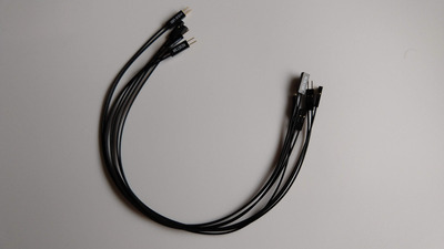

The front panel jumpers also didn't match the case so I had the fun job of using extension cables and matching the pinouts from the old motherboard to the new one. The case needed a new IO shield too, but I found a very nice matching one in my parts bin.

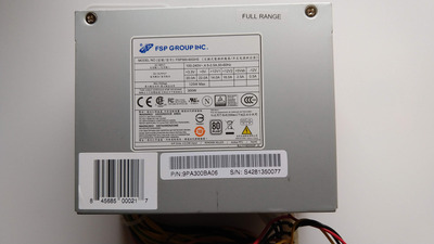

The old Compaq PSU did not have enough juice to even powerup this motherboard, so I ended buying a FSP300-60GHS 300W. There were not many PSUs tiny enough to fit in this case. I chose this one over the others because it was newer, had decent reviews, and was 80plus certified. Didn't come with enough cables, but thankfully I had a few power splitter cables to cover the shortfall.
All in all, I am quite happy with both the motherboard and the PSU.

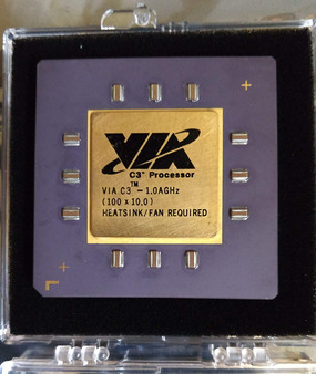

The VIA C3-1.0AGHz CPU Ezra-T 1GHz 100x10 CPU doesn't exist according to Wikipedia. While it is less performant than the 866 MHz P3 CPU it replaced, in comparison, it has been completely rock solid in DOS. It has 15 multiplier steps from 3.0 to 10.0, in half-steps. With SetMul by @gerwin, I can set the multiplier, disable the L1 and L2 cache, and even disable the L1 I-Cache and Branch Prediction, so I was able to get a good variety of speed options:
Setting					SpeedSys	Equivalent
10 l1e l2e ice bpe 529.35 PII-400
5.5 l1e l2e ice bpe 291.19 PII-233
3 l1e l2e ice bpe 158.83 P-133
3 l1e l2e icd bpd 26.77 486DX2-50
3 l1d l2d icd bpd 12.66 386DX-40
Unlike THROTTLE.EXE, using SetMul does not cause any stuttering of video or sound, nor any hangs. And being able to get to a 486DX2 speed was really nice, as most speed-sensitive games seem to run best on a 486. Best of all, I don't have to set any jumpers or go into the BIOS to make these adjustments. Especially since my motherboard doesn't have any jumpers, and the BIOS doesn't have any options! I "tested" all 45 of my games, and found no issues so far.

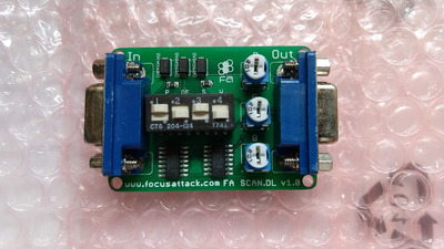

I don't have a CRT, nor do I have the space for one. I had bought a scanline generator for my RetroPie, and I have been using it with this PC. Reading text with it on is not that great, but it looks pretty good in games. It just makes all the pixel art look really smooth and pop out, even though I'm using a 1080p LCD.

Sound is usually the bane of pure DOS PCs. The VIA PLE133T chipset has an integrated Sound Blaster Pro, and I thought it being integrated and PCI it would not be very compatible. I was so wrong - every single game I have tried works flawlessly with it. The CQM FM doesn't sound great, but luckily I have a YMF744 with genuine OPL3 FM. The PLE133T also supports DDMA, so I thought I could replace the SBPro with the YMF744. The YMF744 initializes and plays sounds without the need for DSDMA, which is good. But many games crash when using it. Instead, using the onboard SBPro with the YMF744 for just the OPL3 is a better option. It sounds fantastic and is highly compatible. I followed @johnnycontrario's instructions using VIAUDIO.COM and VIAFMTSR.COM, and it worked great. But I had no way to adjust the volume of the SBPro until I found VIASBCFG by @JazeFox. No need to use either VIAUDIO.COM or VIAFMTSR.com. Great little utility!
I thought I had to have an ISA sound card for DOS compatibility, so I bought an AWE64 [CT4520] for nostalgic reasons. The PCI SBPro + OPL3 combination is so good, that the ISA AWE64 is surplus to this build! I only use it for later DOS games that support the AWE synth, and for listening to MIDI files.
All 3 sound options work in Real Mode, so I have 3 batch files that I can run to initialize each card at any time. I always use the YMF744 for the OPL3 FM, so that's connected to the speakers. The SBPro and the AWE64 are both connected to the Line-In of the YMF744 via a simple stereo splitter, since I never use both of them at the same time. I just needed to fiddle with the volume levels in the mixers for the SBPro, AWE64 and YMF744 to make sure they sounded good together. Works surprisingly well.

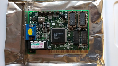

Unfortunately, it still doesn't work. I get "ViRGE not detected". I don't know if thats because it cannot detect my 86c775 base ViRGE DX, or because my BIOS does not let me completely disable the Trident IGP. Either way, looks like no S3D Tomb Raider for me.
Oh, I just took a better look at your picture. It seems that you have an S3 Trio64V2. I'm not sure if that one actually counts as a Virge card, for S3D gaming purposes.
My VirgeDX looks like this.
Reply 17 of 63, by enaiel
Joseph_Joestar wrote on 2020-11-04, 15:54:
You are right. I should probably stop calling it a ViRGE and call it a Trio64V2/DX.

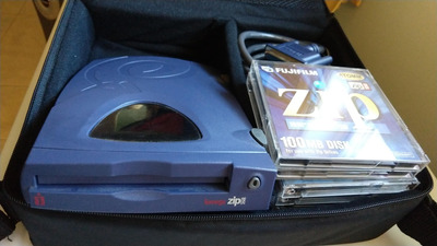

I also have a working Parallel Port Iomega ZIP drive, with 2 100MB and 4 250 MB disks. They were in storage for 20 years but thankfully no clicks of death in any of them.
I got tired of the slow speed and loud noise of old hard drives, so I decided to switch to MicroSD. I'm using an IDE to CF Adapter bracket with a CF to SD Adapater, and a 64GB MicroSD. Works great, fast and absolutely silent. I have working USB to transfer files, but I love just being able to pop out the MicroSD card and copy files or image it for backups.
