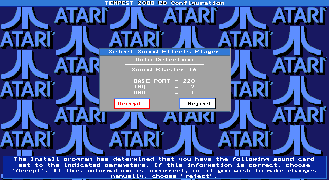

A lot of people say Tempest 2000 runs flawlessly at this point, but there's something that's been bugging me; the voices seem very high-pitched compared to what they "should" sound like, going by the various other versions of the game.
Changing cycles or settings doesn't seem to affect it, even as it affects a lot of other things (around 18000 seems best, btw). I've tried this on multiple machines, with the same effect.

You can run the game with the default DOSBox configuration file, and all you need to do is to set the cycles to max. Now run CONFIG.EXE, select English and choose Configure Sound F/X. Now here's the weird part. If you Accept the stuff it recommended you will going hear the high-pitched voices in the menu. The installer detected a Sound Blaster 16 card with Base Port 220, IRQ 7 and DMA 1.
The attachment config_000.png is no longer available

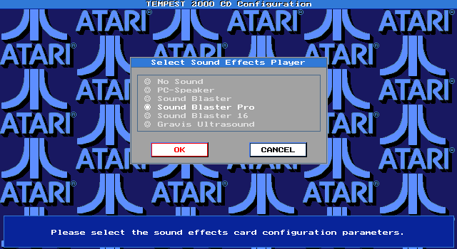

Don't accept the changes, instead click on Reject. A menu will appear with more options. The options I tested were Sound Blaster and Sound Blaster Pro. Both work fine and fixes the issues you have. Choose one of those, and pick 0x220 for the Digital BASE Port, IRQ 7 for the Digital IRQ and Channel 1 for the Digital DMA Channel.
The attachment config_001.png is no longer available
Usually I keep the CD-ROM Music for having amazing CD Audio Soundtrack in the game. Then exit out of the Configuration utility and run the game with TEMPEST.EXE. It's not a big deal of those menu sounds are a bit different. The game works just fine and you will spend most of your time in the game anyway I guess... Probably it works the same on a real Sound Blaster 16 card too. If someone has the game, necessary equipment and free time can please test it for us? Thank you!

Works great! Thanks a lot.
Those "menu voices" are part of the whole voice package; my in-game voices were affected too. Apparently even some sound effects were affected. Strange...
