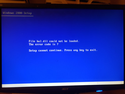

I just won a Socket 7 system in really good shape off ebay. It came with a really obscure Vision Top VT586VX(C) motherboard with a 430VX chipset, that has a P-MMX 233 and 64mb (4x16mb EDO) ram installed. Using a SD-IDE w/ adapter it installed 98 and NT 4.0 with no problems... but it stubbornly refuses to install 2000. At every attempt, right before the "welcome to setup" screen, it stops with "file hal.dll could not be loaded. The error code is 7" 🤬😤

Is there anything I can still try before I look for replacement motherboards?
Yes, I need 2000 to play back MPEGs (won't work right in NT4 and 98 when testing in PCem) and play certain games. Yes, I have installed 2000 with no problems on several other S5/S7/SS7 systems. No, I've never gotten any error even remotely similar on any computer ever before.

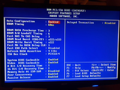

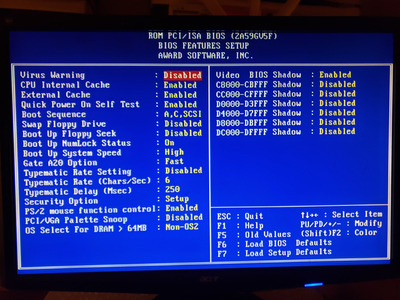

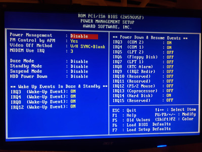

Looks like we've ruled out just about everything, unless it's a motherboard-level incompatibility? Or if there's a BIOS setting I missed:

I wasn't even originally planning on keeping this board, but the PCChips M575 I bought last month to replace it is still on its way from Bulgaria. I thought I might end up keeping this system intact, because everyone says how the VX chipset is supposed to be trouble free (so much for that 🤣) and I managed to score another case in the meantime... but that front bezel arrived in hundreds of pieces 🤣 I'm still in the process of getting a refund for that broken case, but I'm not sure now if I want to replace that case or just yank the VT586VXC and use the M575 in its place as originally planned.
