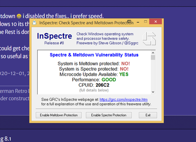

I had to apply both a CPU microcode update and a Windows update to protect my system. I used Cinebench R20 to test the CPU speed before and after, but the difference is very small, only about 1%.
Is this too much voodoo?

The BIOS update and microcode update were separate procedures. I updated the BIOS several years ago but only applied the microcode update a couple of months ago.
My board is this: https://www.supermicro.com/products/motherboa … 500/X8DAL-i.cfm
Clicking on "Update your BIOS" takes you to both downloads. The microcode update requires booting into FreeDOS. (It actually refuses to run in MS-DOS 6.22)
I also manually installed Windows update KB4056895.
With these two things done, the InSpectre tool reported that my system was fully protected.

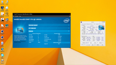

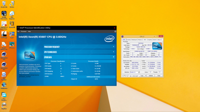

I guess microcode is CPU BIOS. (Apologies to the OP for hijacking his thread). Applying the microcode update changes the CPU revision number but doesn't affect the motherboard BIOS version.
Before microcode update, CPU revision is 15

After update, revision is 1F

(IDK why CPU-Z shows a completely different revision number, and why that number remains the same. I guess this is a bug? It also happens with the latest version 1.24.8.)

So CPU-Z is reading the hardware stepping. Minor changes will be made to the design or manufacturing of the chip to correct errata or improve process yields. Not uncommon for a particular model to have various different steppings. In your case B1 is the only stepping/version for the X5687
Intel's CPUID does not directly tell you the hardware stepping for the CPU, but you can infer it by looking at CPUID. In your case CPUID of 206C2 corresponds to B1 stepping Gulftown/Westmere-EP processors. The revision in this app is as you've noticed the microcode version.
With respect to the microcode updates, you are lucky in that supermicro's latest BIOS for your motherboard includes the latest microcode update i.e 1F. This is the same version that is included in KB4056895. So you do not need that windows update, although having it installed does not do any harm.
The performance hit of spectre/meltdown patches was mostly to I/O intensive tasks IIRC. So minimal in most home use cases. Obviously datacenters, cloud providers and the like are way more likely to see the 30% perf drop that was suggested. Easiest way to mitigate that is to buy 30% more servers I suppose.
