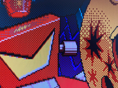

I would like to discuss some general problems that TFTs and VGA to HDMI/DVI Converters show with analog VGA Signals.
So default text mode is 720x400 70 Hz. The 720 horizontal originates from 80 chars with 9 pixels each.
Here the resolution and the mode matches.
However other low res graphics resolutions like 320x200 are also output as 720x400 70Hz mode.
Any device that samples this mode to a digital representation samples 720 pixels. The result is that a checkerboard pixel pattern in 320x200 gets a moiree effect, where each 4th pixel is in the sampled 720 resolution 3 pixels wide.
The checkerboard pattern is then AABBAABBBAABBAABBBAABBAABBBAABBAABBB and so on. (notice the triple BBBs)
The title screen of Keen5 is very suited to check . See attached photo, where the checkerboard pattern has pixels with uneven width.
This is a very general problem where the sampling is incorrect and an artificial moiree effect is introduced. Since a TFT sees only the analog 720x400 mode, it can not know that the displayed resolution might be e.g. 320x200.
From our tests, general TFTs and converters:
If there is a 400 lines mode then it is sampled with 720 samples.
If there is a 480 lines mode then it is sampled with 640 samples.
In case the displayed resolution deviates or is a non-integer of it then the moiree effect comes up.
It also does not help to have a TFT with a high resolution because the effect is already introduced when the original signal is sampled. High TFT resolution blows the moiree effect just up when scaling.
You might want to check your device if you can set the number of sample points to 640 for these modes.
For most of the low res graphics modes sampling with 720 samples is wrong.
There are some eceptions, which is text mode and e.g. from the Quake 1 mode selection modes like 360x350 .

The OSSC has the same problem, it can't differentiate the different 400 line modes unless you manually toggle it

I only did a short test with Commander Keen 5 during which my OSCC (v1.6) did not show the moiree pattern. I think it was in 2x mode.

that just means it was set to the correct sampling profile for 640x400, if you exit keen back to DOS you'd see that the text looks like crap without manually changing it to 720x400

OSSC does, but you have to set it manually for 720x400 vs 640x400 . Automatic detection is not possible, unless maybe if using some fancy image analysis algorithm, but even that would not be fool-proof and would likely require CPU usage and added latency (beyond scope of OSSC) .
EDIT: Actual horizontal resolution of the analogue signal cannot be deterministically detected in this case. It all looks the same to the ADC and digitization logic if the blanking intervals and sync signals are the same, which is the case for 720x400 and 640x400 at 70Hz in DOS . Without actual image line analysis to try to determine how many variations are occurring on a given line, which would not be infallible, determining actual resolution is impossible . Most (all?) LCD monitors with VGA input assume 720x400, which is not perfect for 640x400, but still works .
EDIT2: This is my understanding, please correct me if I am wrong .
