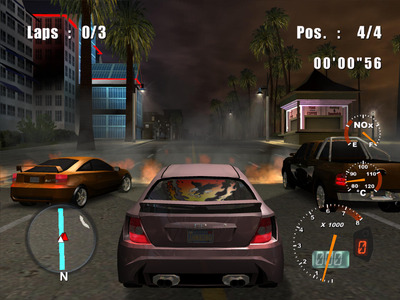

Unknown Nomad wrote on 2020-01-21, 11:06:
Speaking of broken games, Midnight Outlaw: 6 Hours to SunUp, also known as RPM Tuning is essecialy broken on NVIDIA graphic cards. With DGVoodoo2 you can launch it, but most textures will not render correctly (they will be transparent), resulting in an unplayable game. What's worse, this game is STILL SOLD ON STEAM! You can read the reviews there.
Why not post about it on the dgVoodoo forum (that's here on Vogons)?
I also don't see any transparent textures when I try, though I see a lack of reflective textures. WineD3D (4.5) seems to work fine though. DXVK also seems to render the game fine, but crashes on FMVs. Unless I'm missing something (which is pretty likely).
452.16 KiB
4958 views
I had some problems with aspect ratio so I had to run the game directly (bypassing the launcher) with "mainSSE2.exe 2880 2160 32 true 3 1" (width, height, color depth, fullscreen, language and sound), in case anyone is wondering how to get the game running in high resolution without dgVoodoo.
