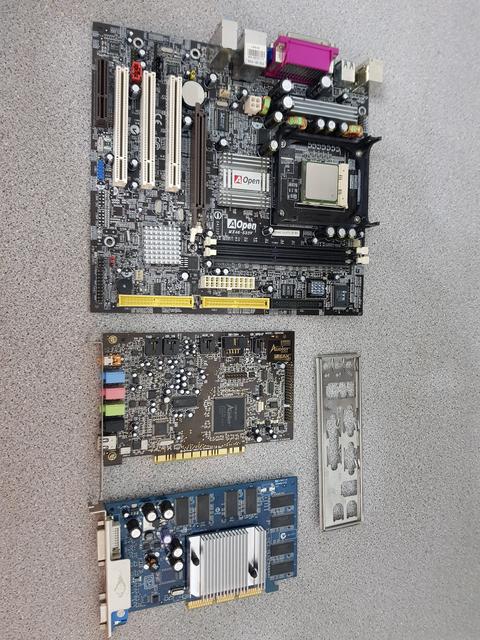

I've built a machine for Windows 98 gaming which consists of:
Pentium 4 2.2Ghz 478 CPU (non HT, Northwood core i think?)
PNY Geforce FX 5200 256MB AGP
Sound Blaster Audigy sound card
512MB RAM
40GB Western Digital HDD

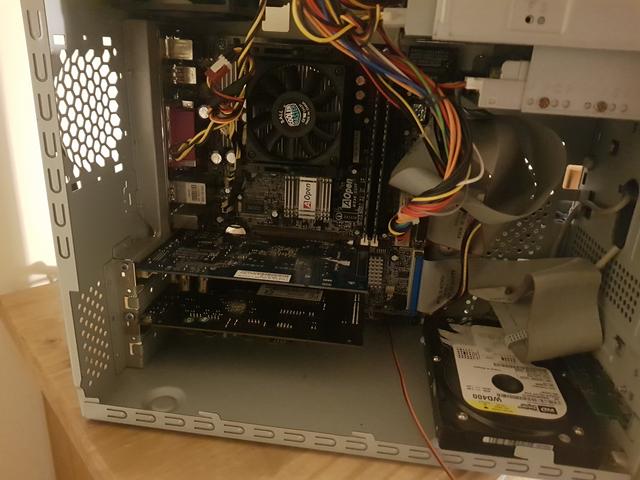

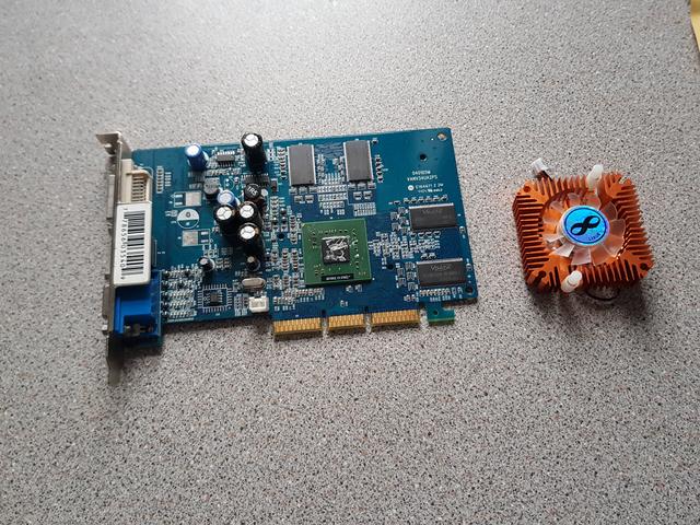

Ok, i've been rather busy with this...

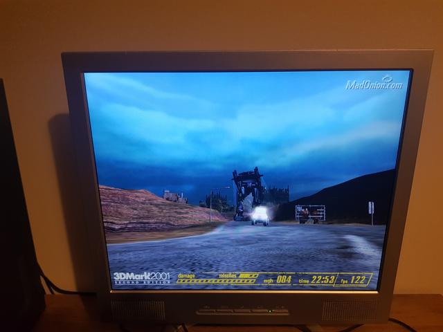

I got my 5700LE card and i tested it in 3D Mark 2001 SE and I went from 5000 or so to 7912 so a huge increase and that's with stock clocks which match my old FX 5200 with massive overclocking potential so very happy with this. Even Windows 98 SE feels smoother when using the start menu which is strange.

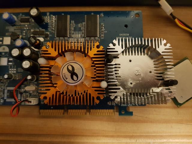

Anyway, the fan was screwed on the FX 5700 LE... Typical eBay so I've stripped the card down and ordered a new pure copper cooler.

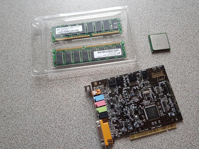

I also ordered some cheap upgrade parts too. I got a ASUS P4R800-VM motherboard with AGP 8x as my current Aopen board is AGP 4x. I got a 2.8Ghz Pentium 4 with 800Mhz FSB over my current 2.2Ghz 533Mhz CPU and i also ordered a Sidewinder joystick for flight sims and a joypad for Jazz Jack Rabbit etc.
As you can see.. I also ditched my Sound Blaster Audigy.. Why? Well... No game port!! 🙁 So i had to order a 00060 Sound Blaster Live! Value model so i can use my game pads. I also got 512MB of DDR400 to swap out my 533Mhz DDR RAM I have currently.
Should be a fairly nice machine once built. 😊

Slowly making more progress... More parts arrived and my cooler for the GPU arrived which I'm very happy with as i literally just guessed it would fit from looking at it on eBay and it's literally the same cooler but pure copper and a working fan!
Also arrived is a my matched pair of DDR400 RAM sticks, my Sound Blaster Live 00060 model and my new Pentium 4 2.8Ghz/512/800Mhz FSB CPU.

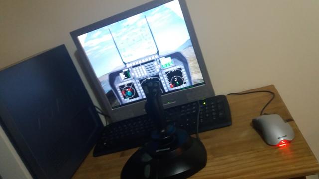

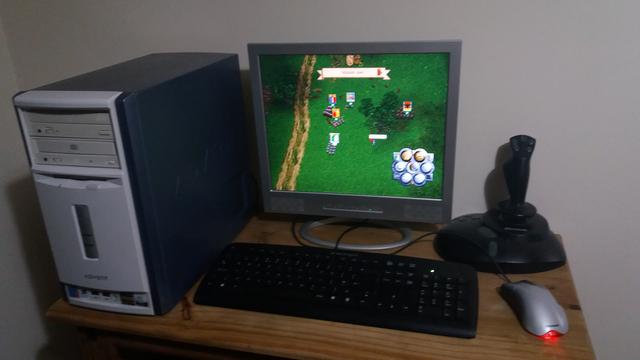

Well... the machine is together at last!
When it works, games are sooo much better, silky smooth but... like i say, when it works... this board does not like windows 9x at all. So many issues from sound to game port to CD drives to multiple BSOD and reinstalls... it's been rough. I don't recommend this board but I hope i can coax it into working as games are so good now when it works.

True DR_ST this is certainly XP era stuff. Plus the manual does clearly state it does not support Windows 98. I knew it was a gamble but the board was literally £9 which is super cheap these are at least £30 on eBay normally.
That said though, after lots and lots of tinkering i have managed to get the machine functional and reliable. Games are absolutely fantastic now with no lowered FPS at any stage or game.
The only thing missing is Sound Blaster 16 emulation which i can live without as i don't do much DOS gaming and if i choose to later on i will actually build a DOS system with ISA slots and all that good stuff.

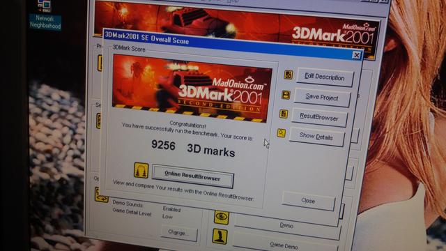

One thing of note which may be of interest to some of you is going from AGP 4x to AGP 8x has made a huge difference. I read online that it doesn't but my results say otherwise. I benchmarked the 5700LE card on my old AGP 4x board and then again on this one once i built it and I've gone from 7900 or so to 9256! From the FX 5200 it was 5700 or so, so with this upgrade which cost me... £23? I've almost doubled my 3D performance which is great.
And that is stock clocks on the 5700LE too which are pretty low. I could easily overclock it to 5700/5700 Ultra speeds as they do so very easily according to posts online. Not going to though as the games i play are old, much older than this system spec it's certainly not period correct this machine but it works for me. The FPS is always so smooth it's pointless to overclock anything.

Also, that cooler is not copper but aluminum that has been anodized with an orange color.
