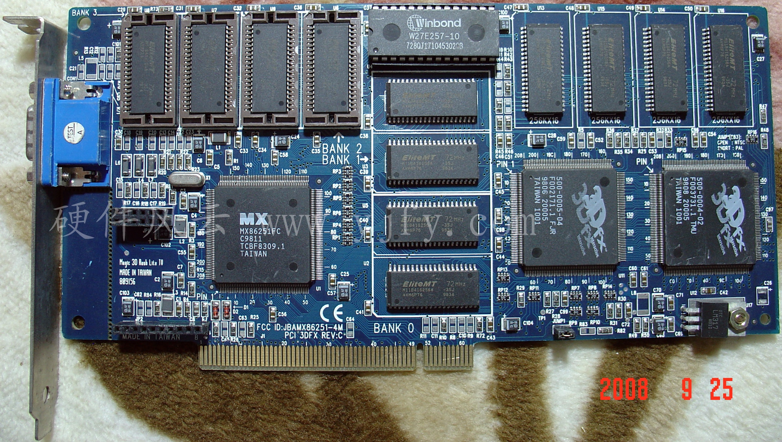

i got this card and i want to know some things because i never had a voodoo rush
1. can i use generic voodoo drivers with voodo rush skywell mgic 3d? or i need to find online the drivers made by skywell?
2. these cards only worked in windows 3.1 and win95 ? or can be used on win98 also?
3. i read that they are not friendly on pentium3 machines, glitches might appear because of speed, and should be used on 486 or pentium1 mmx.
if anyone knows i really appreciate
Reply 1 of 1, by Doornkaat
You can use the regular Voodoo Rush driver for MX cards.
http://falconfly.3dfx.pl/rush.htm
I have used this card under Win98SE with a Pentium II 350MHz and didn't run into any problens.
I hope this info helps. 😀
