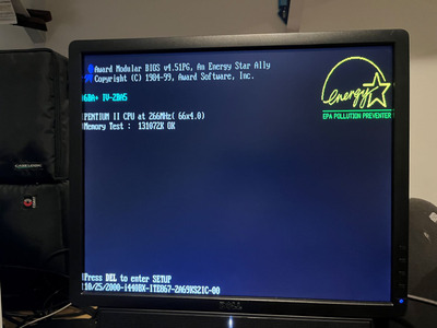

Sometime back in 2023 I grabbed a Soyo SY-6BA+ IV (advertised as working) from Ebay, 100% positive seller.
When I got the board, it did post, got into BIOS, and after a while it frooze. Tried different CPUs (Pentium II, III Katmai and Coppermine), memory sticks, PSUs (which all work with other 440BX boards), reflashed BIOS externally, tried different BIOS chip, etc. I complained and the seller offered to refund the price of the board (but not the shipping) while keeping it , so I ended up accepting with hopes I would fix it eventually.
The motherboard is in very good condition (super clean). I cannot find any physical damage on the board (no scratches, no dents). I did replace capacitors (japanese brands from Digikey), as some of them were not in good shape. I did get the board to post again after doing it, but same as before, it would freeze before getting into DOS. No shorts, all voltages seems to be OK.
As I had other boards and projects to look into it, I put it in storage. Recently I saw a video from Tony359 recovering a Slot 1 motherboard, and he gave me some ideas on what else to look. So I went and checked clock crystall (generating 32.7Mhz), and when I poke the clock IC (W196), all pins seems to have right frequencies (FSO/FS1, PCIs, CPU0/1, Ref clocks, X1/X2, etc). BIOS chip is also receiving clock signal and power from battery (plus VCC).
When I connect a PCI diagnostic card it reads no POST codes at all, however it indicates all the voltages as available, clock led is on, ready off, reset off, and FRAME is off (always). If I hit reset, the led goes on and off as it should. Sometimes after hitting reset, FRAME and READY stays ON, until I try reset again.
The speaker is connected, and produces a continuous sound (very faint), not a beep. Positive Speaker terminal is reading 4.8V continuosly when motherboard is powered, which definitely is not right. Would anyone have any ideas what to look for?
It's not an obssession, I really like the board, and would love to bring it back to live. I did revive some retro stuff by replacing damaged components, repairing traces, etc... it is "easy" to fix things when the damage is visually there, but challenging when everything looks pristine.

Reply 1 of 7, by Aladim
I managed to boot 2-3 times. The picture above is from one of those times when I could get a picture. The board can work, eg, it 's not beyond hope.
