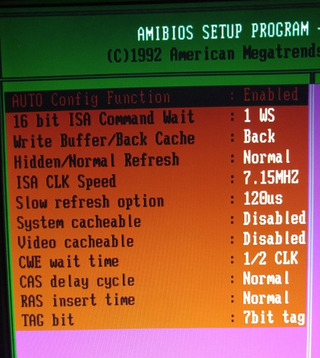

Reply 5 of 5, by BitWrangler
This is all I get in Advanced Chipset menu on https://theretroweb.com/motherboards/s/acer-i … gxi-model-i433a
