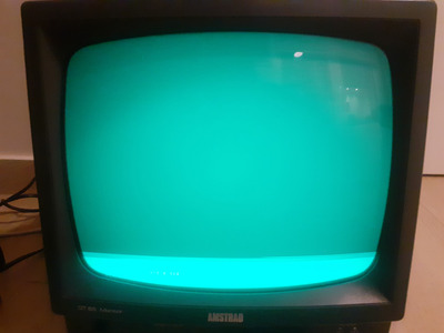

I recently got an amstrad GT64 monitor.
The computer works ok,but the v-hold seems to have a problem.I tried ajusting the pot(something changes on the screen),but nothing
Any ideas?

(At the bottom,the "BASIC 1.1" is readable)
Reply 2 of 9, by Deunan
Open potentiometers (usually due to dirt on the wiper contact, not because of part failure but that also can happen) anywhere in the V-sync path can cause that. V-hold, V-size, V-position (this one is less likely), and some of them might be not user controls but adjustable on the PCB inside the monitor.
Then there's the usual culprits - electrolytic caps. Now, even the slow vertical would be using a stable film capacitor and not an electrolytic for the sawtooth generator but there might be issues in the power supply (like excessive ripple) that throw the sync circuit off. And these monochrome CRTs often have a cap in the yoke coil circuit rather than direct connection to GND (as a safety measure). If that one dries out then the feedback loop might not be able to work out the frequency difference. Though that would usually also result in partially collapsed vertical and/or pretty horrible sweep linearity.
And obviously it could be that your Amstrad machine is not outputting the V-synch pulses properly for some reason (usually also caps or bad transistors). Be sure you are not chasing ghosts, test the computer on TV or another monitor first. If you are sure it works properly then spray the control pots with suitable cleaner spray (there are also cleaner+lubricant combos). If that doesn't work you'll have to investigate the PCB pots and capacitors, and power supply output. These monitors are easy and fun to work with - if the tube is good and flyback transformer is not dead then everything else can be repaired or replaced.

Tried cleaning the pots,not helped.
When I ajusted the small pots on the pcb something changed,but I don't know exactly the pots I must ajust.

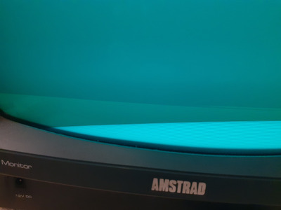

Reply 6 of 9, by APOPAP
The lines now go higher

APOPAP wrote on 2024-10-18, 13:41:
Don't just blindly turn the PCB pots - you will do more harm then good. Unless you only moved them just to rule out wiper issues and returned the pots to the original position.
There are service manuals for these monitors available for free, like here: https://www.grimware.org/lib/exe/fetch.php/do … ctm640.gt64.pdf
Check VR701 (V-HOLD) resistance, that it is not open (or shorted somehow). Check VR702 (V-SIZE) and VR709 (V-LINER) as well. And make sure you got the symptoms right - it's hold issue if the screen is rolling. If it's just too big and picture ends up beyond visible screen area then it's a size problem (and most likely that would be an open pot).
There really isn't much here to check. Start with the PSU voltages and in fact the schematic gives you typical voltages for all 10 pins of the vertical deflection IC (both on the drawing and in the corner). Since it's an IC and those typically either work properly or not at all you can focus on all the parts around it. Check the pots, diodes, resistances next if the voltages are fine (or, if one is badly off then it's an obvious hint). This is a super simple circuit, it picks up the combined signal from the collector of Q601 and the IC does all the rest internally. Unless it's a yoke issue (very rare on these) it has to be one external parts I mentioned, or perhaps a broken connection (cracked or cold solder for example) somewhere.
Don't start randomly tweaking and poking things, you'll only make things worse. Stick to the manual and schematic.
