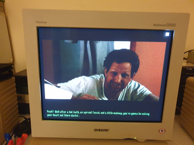

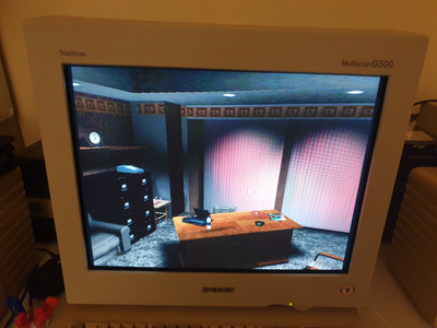

Reply 8 of 9, by AppleSauce
Garrett W wrote on 2024-05-09, 07:54:
Yeah those community installers for eliminating disc swapping on the CD version are not the same thing. The DVD version actually features MPEG2 video at 30fps and much greater quality than the CD version (which runs at 15fps). It really is a massive leap in image quality.
It's also one of the first games to do so on the PC platform (it was supposed to come out in late 1997, but the launch slipped to March 1998 I believe), as such when it was released it only supported a few MPEG2 decoder cards and this is where the issues with running it today (and at the time honestly) reside.
Eyy thanks so much for the help I've got it working , turns out I needed the klcodec to work , the one you suggested was a bit too new but I managed to find version 234 , I already had DVD EXPRESS and Elecard.
After all that the game still refused to get me to the main menu so I could set the mpeg device to dvdexpress , but I did manage to do it in 86box , and then what I did was copy over the files from my 98 install on 86box and overwrite the pentium 3 systems copy of overseer , then it managed to run.
I adjusted some settings and so far I got to the office. So hopefully that should be it.
Phew I guess that's part of the fun with retro pcs you need to fight your system every time you want to set up a game the way you want. Then the reward is being allowed to play the game.
