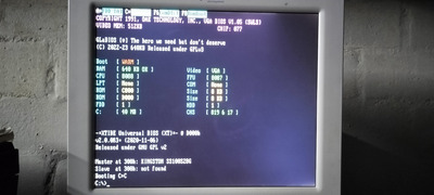

640KB wrote on 2024-04-26, 15:16:
If you look in the ROM at file offset 025B you can see what would appear to be drive type tables with five built in drive types. […]
                                                              ; #  Cyl  H  RWC  WPC  EC  Step  SPT  Size  FMT
0000025b 67 02 04 67 02 67 02 0b 05 00 00 00 00 00 11 00 ; 0: 615 4 615 615 11 5 ... 17 20MB MFM
0000026b 25 03 02 25 03 25 03 0b 05 00 00 00 00 00 1a 00 ; 1: 805 2 805 805 11 5 ... 26 20MB RLL
0000027b 25 03 04 25 03 25 03 0b 05 00 00 00 00 00 1a 00 ; 2: 805 4 805 805 11 5 ... 26 40MB RLL
0000028b 25 03 04 25 03 25 03 0b 05 00 00 00 00 00 11 00 ; 3: 805 4 805 805 11 5 ... 17 28MB MFM
0000029b 34 01 04 34 01 34 01 0b 05 00 00 00 00 00 11 00 ; 4: 308 4 308 308 11 5 ... 17 10MB MFM
So yours would appear to be none of those, in theory you could replace one of the built-in types with this:
0000025b    34 03 06 34 03 34 03 0b 05 00 00 00 00 00 11 00   ; 0: 820  6  820  820  11  5 ... 17   40MB  MFM
It works! Full 40MB available! I could've just resized the partition (it was still valid but didn't boot anymore, I think a sys: would've fixed it) but all the data is available on a second disk so I just reformatted it and copied its system back. Thanks a lot!

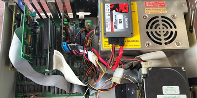

I've been working quite a bit on this XT, driving around getting more parts for it. It now has 640KB RAM (it's like you!) and an FPU which it didn't before. I also noticed today that the turbo button jumper was unplugged all along so I didn't even notice my XT has been running at 4mhz instead of 8mhz all along (could GLaBIOS also show turbo status, seems like it might be handy for some to avoid this issue).
I also added XT-IDE with a SATA adapter and an 8GB SATA SSD. It's really convenient for copying files over because I can just plug that into a USB adaptor on a new computer.

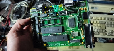

Last night I also found this really nice multi-io RTC card. But it had a varta battery on board that was already spewing acid all over the place. Card doesn't detect at the moment, but I'm going to fix it up more so that I can get more GLaBIOS output on the screen more than anything else. I'm borrowing a friend's eprom writer at the moment (he wrote me GLaBIOS in December and I only got to actually try it out a when I started playing with this XT now) and I want to write the newer version so that I can get that pretty 2024 date on my archaic hardware.
The battery area on that board does look a bit worse for the wear. I can see the crystal typically used for a RTC clock but don't see a discrete clock chip so I assume it's part of the ASIC package? I can't tell from the markings exactly what it is. Do you have any docs on it?

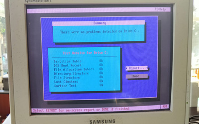

Personally, I'd run Scandisk on it to make sure all 40mb is readable

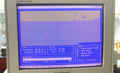

Norton disk doctor gives it an OK! I'm quite surprised that it completes a surface scan in under 3 minutes being on such an archaic interface!

If you do some math...
40 Megabytes divided by 3 minutes =
227,5 Kilobytes/s
Seems about right for that archaic interface 😀
maybe a bit slow, I think RLL & MFM were faster
Do not ask Why !

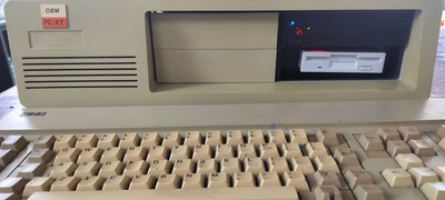

I'm attaching some pictures of this build so far. It still needs a lot of work, lots of old parts were exposed in my garage so there's some reckless paint droplets that I'll get off along with a good scrubbing.
The red LED on the front is power, blue is turbo, the green one is the Seagate's built-in activity LED, and there's a yellow one I had on the XT-IDE for the SSD, although for some reason it didn't flicker, might need some jumper adjustments I still haven't had time to really look at that.
I went with a 1.44MB floppy drive since my 5'1/4" drives seem to all be dying, and it makes interoperability between all my ATs a bit easier (even though I can just format then as 720k in the XT, still plenty for a boot disk). Would be nice if there was a 1.44 BIOS extention available. I'm going to try to get it fitted a bit better with a 3D printed frame so that it looks a bit better.
Also, that floppy drive was a batch of 10 new old stock that I bought last year (R14 is less than a euro, so this was totally worth it). For some reasons the black drives are 5x the price, but I'll order one of these so that my XT facade at least looks a little bit more consistant. Oh yes we call 1.44MB floppy drives "stiffy drives" in South Africa. Just deal with it. 😎
https://www.geewiz.co.za/hard-disk-drives-ssd … rive-beige.html
https://www.geewiz.co.za/hard-disk-drives-ssd … iffy-drive.html

a nice full clean photo of only your mainboard would be great to identify perhaps chipset or brand model or which bios would be best.
I can almost see the chipset underneath the sata adapter&cables.
Can you change the turbo whenever you want using the button/jumper or do you have to reset it after changing the button/jumper ?

It doesn't entirely explain though why @highvoltage can't dump the ROM from that ISA card.
@highvoltage, what happens if you try now to dump that rom using DOS 5 debug to a drive on your XTIDE card? That typically uses PIO for transfers so would remove DMA from the equation.
