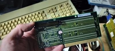

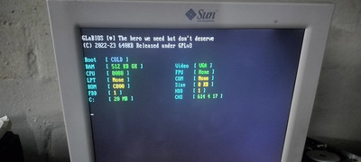

Hey everyone, this is my first post to Vogons after curiously reading it for years!
Yesterday I toyed around with an ISA card I found in a trash heap of a friend. It's an 8 bit card which appeared to have an IDE port on it, so naturally I was curious about it and grabbed it.
After some experimentation and lots of reading, I discovered that it was an XTA card (like ATA, but for an XT). Few drives are supported, but by coincidence I had an old ST351 A/X drive (I collected this because it was the first ever disk we had in our family 386 when I was little), which supports both ATA and XTA modes via a switch in jumper (hence the A/X in the model name).
I tried it out, and it worked! I now have an XT with an open source BIOS (GLaBIOS) booting an XT era IDE machine without using something like XT-IDE.

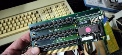

My only problem is that the 40MB disk is only identified as a 20MB disk, the jumpers on the disk is correct. I think this might be a limitation on that card I got. I'm adding a video of it booting, along with a picture of the card. Anyone else have any experience with this kind of hardware?
Also, can anyone identify the card? My best bet is that it was meant for an upgrade to Twinhead XTs, since they utilised very similar looking cards originally (although without the IDE interface).

Reply 7 of 61, by 640KB
Yeah, GLaBIOS calls the HD controller's BIOS after it's set up its drive table to get the number of drives and sizes (INT 13h, AH=8) and displays that. I'd take a guess that those two jumpers on the right select one of four built-in drive types in that ROM... since what's it's reporting is a bog standard 20MB drive's geometry, the controller seems to be working correctly. The question is... what size does DOS see in FDISK (warning: any attempt to write to the disk will certainly result in data loss, so if you've got anything on there you want, back it up first 😀 ).
As @weedeewee mentioned if you wanted to dump that ROM we could probably confirm this and maybe patch in your drive geometry (if it's not already one of the built-in ones).
640KB

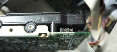

I did another stab at playing with jumpers, here are some results:
There's 3 pins on the left, and 6 on the right, I made up some names for them:
       .                   :  J2
: J1 : J3
: J4
I've found that whenever J2 is closed (with nearly any other combination of jumpers), the bootrom loads at CA00 and no drives are detected.
When J3 is closed, nothing is detected.
When jumper J4 is shorted, the ROM still loads at C800 and the disk is detected as 20MB.
I've tried the above with J1 being up and down and clear, it doesn't seem to have an effect.
I'm attaching an image with the drive jumpers as well, this should be XT mode 40MB according to
https://stason.org/TULARC/pc/hard-drives-hdd/ … -SL-IDE-AT.html
(search "XT jumpers") - seems like the headers are upside down from what I would expect, I'm going to go test this yet again (also a bit nervous with this disk, since the wrong jumper settings can destroy it)
Thanks for reading!
    43.54 KiB
    602 views
    ST351A/X jumpers

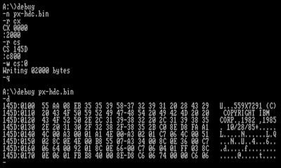

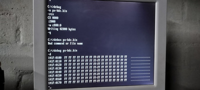

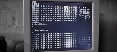

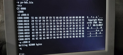

Reply 11 of 61, by highvoltage
weedeewee wrote on 2024-04-25, 15:23:
the first two bytes should be 0x55 0xAA […]
debug
n PX-HDC.BIN
RCX
2000
W C800:0
Q
Thanks weedeewee! That was very helpful. If I do the -d, I see something that looks like a ROM and even a copyright string (picture attached)! But when I do a w (even from scratch verbatim as above), I just get a file full of hex FF.
Any ideas?
    113.4 KiB
    568 views

Reply 15 of 61, by highvoltage
weedeewee wrote on 2024-04-25, 16:16:
Wait. with this screen output, you say the file is filled with FF ? I just tried the same steps here in a dosbox and it works f […]
I just tried the same steps here in a dosbox and it works for me.
to view the file
just
debug PX-HDC.BIN
d
q
Yep, it looks like it dumps it fine to screen, but not to disk... photos attached.

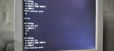

Reply 16 of 61, by weedeewee
ok maybe
debug
n px-hdc.bin
M C800:0 2000 1000:0
W 1000:0
q
Which DOS are you using ?
Do not ask Why !

Reply 18 of 61, by weedeewee
you made a typo 😀
not once
not twice
but three times !
debug
n px-hdc.bin
^ !!!!!!!!!!!!!!!!!!!!!!! it's an m for mama or mother or majestic !
W 1000:0
q
Do not ask Why !
