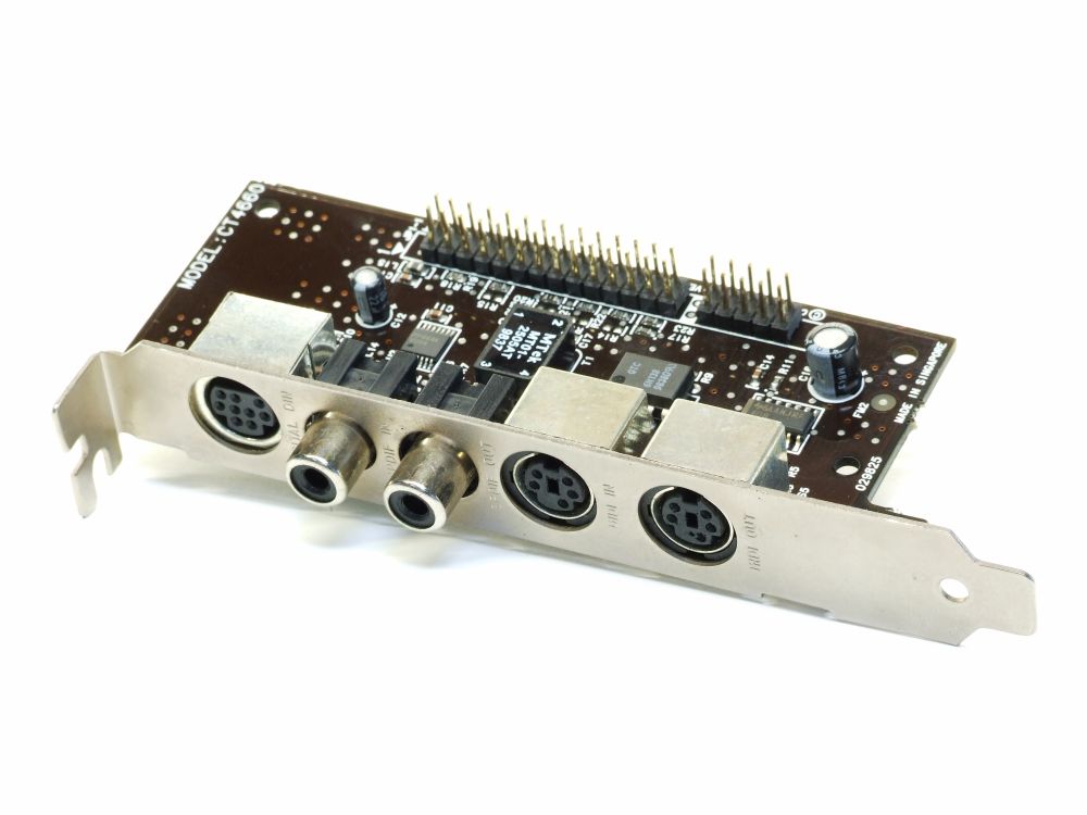

Reply 14 of 63, by florian3
DerBaum wrote on 2024-01-07, 16:43:
whats the difference between a gameport breakout cable and a midi cable dangeling from the back of your pc? […]
florian3 wrote on 2024-01-07, 16:34:
Eivind wrote on 2024-01-07, 15:02:
As for MIDI, that's already present on the DB-15, can be broken out into full-sized MIDI in/out connectors with the ubiquitous adapter/cable, like this one:
Personally I just find those breakout cables inconvenient and if I was in the market for another one I wouldn't even know where to buy one that is built correctly. But I still prefer those over mini DIN 😉.
I would suggest internal headers on the card to attach your own types of connectors, like the seperated midi signals from the gameport into a midi connector. Then you can have a nice second slot cover if you really want.
BUT think about the size of midi connectors... you will probably have to break them out into smaller connectors and then build a adapter to full size midi... Like creative did on the early live cards with external midi but without the frontpanel.
Imho the gameport MIDi is fine for people that actually need MIDI input. But most probably don’t and then you have an extra unused 2m MIDI-In cable dangling behind the computer.
For the Mini DIN MIDI ports that Creative, Roland etc used you can’t easily get adapter cables for.
The 3.5mm TRS to MIDI adapters on the other hand are readily available, the connectors and ports are more robust than Mini DIN, and easy to plug in without crawling behind your computer with a flash light.

Reply 16 of 63, by Eivind
florian3 wrote on 2024-01-07, 17:25:
Yeah I wouldn’t trade the DB-15 for a TRS midi out if there is no space.
You could also look into those 3.5mm/Toslink combo ports.
Yes, I remember those from my minidisc days! 😁 Don't think I've ever come across those connectors, but maybe I haven't searched enough. Let me know if you can find them in stock somewhere!
