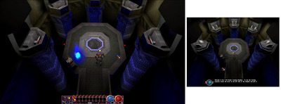

I just installed the version from The Collection Chamber and everything's fine except one thing: the top and bottom of the screen are cut off in the default configuration.
The game originally ran in 4:3 and I want to play it that way because with so much screen space cropped I can't even target some objects when the camera's fixed. Pictured in the attachment: on the left is a screenshot I just made and on the right is a screenshot from someone's Youtube playthrough. The other attachment is the game's dgVoodoo.conf
Can somebody help me out? I tried all kinds of options in the dgVoodoo panel, but I can't prevent the cropping.

You force the resolution to 1920x1080 (which is 16:9) through dgVoodoo for a 4:3 game? Why not just 'max' or 'max_isf' and let dgVoodoo calculate you the maximum reasonable resolution?
Also, I think the image is not cropped, probably you can zoom in/out somehow.

I just tried Max, Max ISF and custom resolutions such as 1440x1080 (4:3 with maximum vertical resolution). No dice.
I can zoom in and out (there's keybinds for those actions) EXCEPT that specific room (has a fixed camera angle), so it's not that either.

Have you actually set the game to a 4:3 resolution from the launcher?
I just set the resolution in the game launcher to 1024x768 and it works. Thanks.
I miss obvious solutions way too often!
