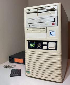

Recreated with some owned authentic components and running Win95 OSR1. Targeted games: 1989 – 1994.
Highlight parts:
  • AMD Am5x86-P75 at 160MHz (WT), turbo is 386DX-25.
  • QDI V4P895GRN/SMT with 256KB cache
  • 16MB FPM
  • DTK PTI-265W VLB multi I/O
  • Trident TGUI9440AGi VLB 1MB
  • Media Vision Pro Audio Spectrum 16 SCSI
  • ESS Audiodrive ES1868F for MPU-401 and SB emulation
  • Philips CDD3600 SCSI 6X CD-R
  • Teac FD-55GFR
  • Chinon FZ-357
  • Roland Sound Canvas SC-55

The attachment vlb 486 160 6x front with sc-55.jpg is no longer available

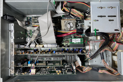

The attachment vlb 486 dx4 120 16mb pas16scsi es1868f trident inside.jpg is no longer available

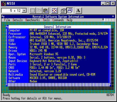

September 2023 update:
RAM is upgraded to a single 32MB FPM module (Texas Instruments TMS417400ADJ-60)
Bus frequency increased to 40MHz, the CPU runs as DX4-120 now. With two VLB cards I am not seeing any instability.

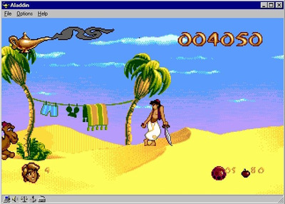

So the system runs Windows 95 OSR1 now (the one without Internet Explorer, USB, etc.) and I also tested some Windows games:
  • Breakthru! (Spectrum HoloByte, 1994)
  • Lode Runner: The Legend Returns (Sierra, 1994)
  • 3-D Ultra Pinball (Sierra, 1995)
  • Aladdin95 (East Point Software, 1995)
    The attachment aladdin 95 epi.jpg is no longer available
All running well.

NSSI for the new config
The attachment nssi win95.jpg is no longer available

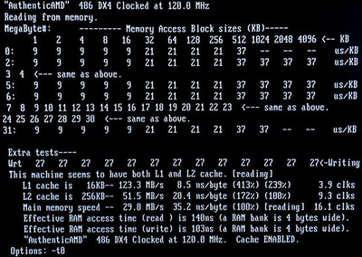

CACHECHK v7 by Ray Van Tassle: 123.3 MB/s, 51.5 MB/s, 29.8MB/s
The attachment cachechk 32mb dx4-120.jpg is no longer available

Reply 11 of 12, by Bruno128
Build update: Added Roland SC-55 (gameport to MIDI cable). New photos in OP.

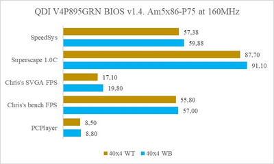

Hi I made progress on this. The turbo switch functionality breaks (freeze / suspend) not because of the BIOS update itself as I thought in 2022 but because of JP18 in 1-2 (Write-back cache).
I used the latest BIOS from November 1995 again, setting JP18 to 2-3 and the AMD-X5-133ADW now runs at 40x4 with L1 cache set to Write-thru. System is stable and fast and most importantly the Turbo function works correctly.
Turbo button slows down to 486DX-33 levels and pressing Ctrl-Alt-minus slows it further to 386DX-25 levels. Unlike some Pentium boards this hotkey combo also works in Protected mode (Win95) and on-the-fly.
DRAM timings: 4-3-3-3, 1WS. Cache timings: 3-1-1-1, 0WS.
The attachment am5x86 wb wt benchmarks 160mhz.jpg is no longer available
