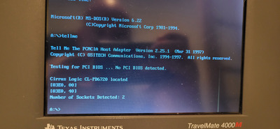

I've spend weeks trying to get an old Texas Travelmate 4000m Laptop up and running.
The main problem is that the CMOS Ni-Cd is a few mm from the IDE connector. I've definitely come to the conclusion the IDE connector is dead following a battery leak. I've tried 3 different hard drives, 2 cf cards, 2 different cf card readers etc and everything just returns Fixed Disk Error and sometimes Fixes Disk Controller Error but there's no obvious pattern as to when you will get either.
I had read at one point that it was possible to run a laptop with a bootable floppy and a PCMCIA CF card reader , which CF Card. My BIOS is too old to boot from the PCMCIA. I do have a SCSI port, but I don't think an external SCSI drive would help as I believe that needs drivers too.
Has anyone actually had any success running off just a bootable floppy and a PCMCIA CF Card? If so how did you do it?

Reply 4 of 10, by ldare1000
Thermalwrong wrote on 2023-09-05, 17:31:
I've done the same with my NEC Versa V50 which doesn't have the caddy (and won't, costs too much) - see this post for a summary […]
I've done the same with my NEC Versa V50 which doesn't have the caddy (and won't, costs too much) - see this post for a summary of my experience with it: Re: What retro activity did you get up to today?
Here's the boot floppy I used, which loads dos 6.22 with Cardsoft / Cardwizard, to initalise the PCMCIA ATA Flash card I use as a hard drive:
"A Dos 6.22 boot disk configured with PCMCIA for this NEC versa V/50 laptop. This allows the laptop to use the lower PCMCIA slot as the C drive and run programs"
Fits into 1.2MB with the PCMCIA drivers, himem, edit, memmaker and CD-ROM drivers too. This is actually a pretty hacked up install of cardsoft that I've made from a couple of versions to make the boottime far more tolerable. Mostly it's Cardsoft 3.1 but it uses the CARDID.EXE from 3.0 because it loads faster from a floppy.
In my notes I mentioned which slot the ATA Flash card goes into because the ATADRV driver allocates the first available drive numbers to slot 1 then slot 2. On this the lower slot is slot1 so it's seen as the C drive.
It's currently using Cirrus Logic socket services (sscirrus). You should be able to use it by changing the socket services for either the intel 365 compatible one, or the TI socket services, I've attached a collection of the socket services drivers that should work. If it doesn't work, boot up from the floppy and run cardwiz\config.exe and go into the bit to scan and allocate resources. You might also need to change the memory exception area (c000-cfff) but it should work on most laptops I think.
For command line switches and stuff - generally you don't want to get to that level past specifying the number of slots, check out this document "cardsoft_technical_guide_SWM640020018A.pdf"
Thanks for your posts. I didn't get notifications from this thread so didn't know so much useful stuff was here. Thanks so much!
Your bootable floppy is booting my laptop, and from the attached it looks like I have the same, and it's working!!!!!! I can't thank you enough!!!!!
Really really happy. Thanks

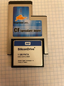

Reply 5 of 10, by ldare1000
Hi All
I'm running absolutely fine on a 256mb CF Card. I've found my 1GB card I got second hand recently, it works fine in Windows 10, but won't read on my 486 DOS 6.22 laptop. Do I need to configure it first?
FDISK says unable to find fixed disk and IDEINFO can't see it.
Ta
Reply 7 of 10, by ldare1000
This is it. Western Digital. I had an old external USB drive which I recycled with an IDE to CF Adapter.
In the 486 laptop , I'm using a PCMCIA adapter, not the adapter shown.
Ta
Reply 8 of 10, by Bondi
I have a similar card that works fine on old laptops. However your says SiliconDrive II, maybe that's the reason.
Anyways, I'd try to make a partition with pcmfdisk.exe tool that comes with PhoenixCard Manager (note it requires all Phoenix drivers loaded). It's usually my last resort if it comes to making working/bootable CF cards.

Reply 9 of 10, by ldare1000
Bondi wrote on 2023-09-21, 11:06:
The Texas Travelmate Manual suggests I have PhoenixCard but I'm running Cirrus successfully at the moment. Maybe I should try an older card as you suggest.
