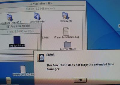

i know the it says this for old pc hareware but hoping someone could help
i have an old imac g3 (early 2001) model with mac os 9.2.2
i am been trying to some old games but the is one that i can not get working on imac g3
the game is are you afraid of the dark the tale of orpheo's curse
the error massage say - this macintosh does not have the extended time manager
no idea what that means
no idea if it is a os thing, machine thing, software thing or extension thing
any help would be greatly appreciated

This is pretty much all the Mac OS 9.1 changelog says, it's part of the "System" file (is it still a "suitcase" you can add and remove extensions from? shouldn't be since OS 7...) so no real idea apart from trying a clean install (preferably of the recommended OS for that program, since at no time in history was Apple particularly notable for backwards compatibility)...

will try a clean install and this model of g3 only goes as low as mac os 9.1
weird thing is when tried it on my ibook g4 in osx tiger "classic" mode the game runs fine

I tried that game on my beige G3 233MHz tower with OS 9.2.2 and it ran just fine. So the OS version can't be the problem.

thank you, at least is not an os issue, one ruled out 😀
