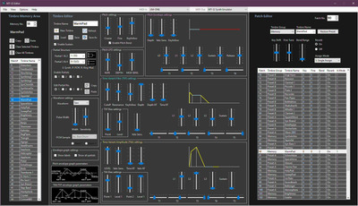

Hello everyone- long-time listener, first-time caller.
After getting my hands on a hardware MT-32 for the first time last year in early 2022, I found myself both fascinated by the potential of the synthesiser and frustrated by the clunkiness of the available editing tools, which (unsurprisingly given the age of the device) seem to mostly date from the early 1990s.
At the beginning of this year 2023, I finally bit the bullet and started work on making my own timbre editor and patch librarian in Visual Studio. Whilst it's still a little rough around the edges in places, I think it's now working well enough to release it into the wild:
MT32Editor_v0.9.10b.zip
1.3 MiB
15 downloads
MT32 Editor Windows executables and notes
GPL-2.0-or-later
The main application should work on any Windows 8, 10 or 11 system with the .NET 6.0 runtime installed. I've tested it with my hardware MT-32 (v1.07), CM-32L (v1.00) and Munt (connected through the MME driver, mt32emu_win32drv). EDIT- I've successfully tested it on Ubuntu too, with the latest versions of Wine and wine-mono.msi. I've also now released a 'legacy' version, which only requires .NET Framework 2.0 and so should run on any PC running Windows 98, Me, 2000, XP or later.
I've licenced the software as GPL3- full source code is available at https://github.com/sfryers/MT32Editor/releases/v0.9.10b.
Enjoy, and please let me have any feedback - this is my first attempt at coding anything in C#!

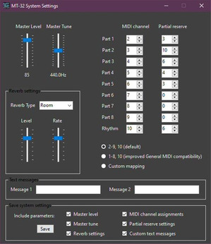

I've definitely learnt an awful lot about the MT-32, SysEx and Visual Studio over the last few months.
The Master Tune parameter is an interesting one- the MT-32 user manual states that a SysEx value of 0 = 432.1Hz and a value of 127 = 457.6Hz. This would place the middle of the range somewhere around 445Hz. I'd be interested to understand whether the device is actually tuned to 445Hz by default, or if the default Master Tune value is below the middle of the range at 440Hz.
MT-32 Editor- a timbre editor and patch librarian for Roland MT-32 compatible devices: https://github.com/sfryers/MT32Editor
Reply 3 of 127, by SkyHawk
sfryers wrote on 2023-04-07, 20:16:
Well, I just so happen to have an MT-32 on my desk....
[MASTER VOLUME] + [SOUND GROUP]
Default appears to be 442.0Hz, with a range of 427.5Hz - 452.6Hz
Reply 4 of 127, by sfryers
Thanks- I've been so focused on the SysEx specification that I must have missed the page in the manual showing how to change the tuning from the front display.
The scanned copy of the MT-32 manual at https://www.manualslib.com/manual/691647/Roland-Mt-32.html therefore contradicts itself between page 18 (Master Tuning) and page 42 (MIDI Implementation, System Area)- where the range of tuning values is show as being 5Hz higher. The copy of the CM-32L manual on the same site does show the correct range of 427.5-452.6Hz in its MIDI Implementation section.
I'll make a note to alter the values displayed in the application accordingly in the next build. For now, the master tuning value displayed in the software is 5Hz higher than in reality.
