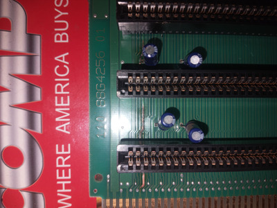

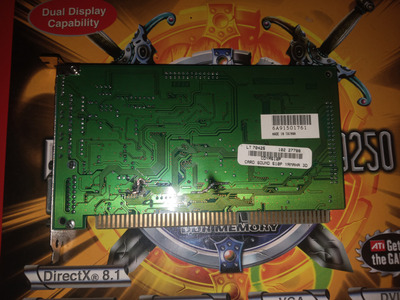

I've been tinkering around with old computers for years now, and I've never had a computer component smoke on me. It startled me quite a bit, and I unplugged the thing as fast as I could but the damage was already done.
The sound card started quietly crackling and shot out a fair bit of black smoke, making the living room smell strongly of ozone. I'm assuming this was my fault, as this was in the 486 system I modified in 2019. Long story short, one of the things I did involved slicing the riser card completely in half, sanding down the cut edge, and covering it with contact adhesive to seal it. I made sure that none of the traces were still sticking out and touching, but I must have made a mistake somewhere.
The Sound Blaster Vibra 16S I used in it for years has some missing pins on the edge connector, and my theory is that most of the traces in the riser card were okay, with just one or more shorted ones on the pins that never got used. The moment I put in the Yamaha YMF-718s, which uses all the pins, and turned it on, the shorted pins were used, and this was the result:

The burnt trace on the ISA riser card seems to be B3, which is the +5V supply. Obviously a very high current (tens of amps?) was conducted through it. On the sound card, it also is the +5V trace that is burnt. You get burn marks both on the trace from B3 to the configuration EEPROM (the 8-pin 93C66 chip) and from B29 to the configuration EEPROM. Both B3 and B29 are +5V pins. Possibly you did nothing wrong with the riser card, and the sound card was shorted already before you inserted it to the riser card. Primary suspect would be the ceramic multilayer capacitor CB14 next to the 93C66 chip in that case. Those caps tend to fail short if they are mechanically stressed too much.
The damage is not as bad as it looks. You burnt some of the solder resist lacquer, you can apply nail polish as replacement to restore insulation. Those traces are really wide, so if the trace is broken, it's again easy to fix it. So a repair plan would go along like this: Check for continuity of +5V on the riser card, check for shorts from +5V to GND. If everything is fine, clean the burn marks and apply nail polish. Check the sound card for shorts from +5V to ground. If the sound card is shorted, try to remove CB14. If you can get the short removed from the sound card, it's again cleaning up and applying nail polish. In case the short on the card originated form a shorted capacitor labelled CB, it should be replaced in the long term by a new 100nF multilayer ceramic capacitor.

Thank you mkarcher, I'll see if I can get a multimeter and test that out. Best case scenario is that the riser card is fine, and I can use it to put a sound card back in the machine (likely another Vibra 16s). I've never tried soldering before, so I'm not sure that I could replace the cap on the sound card or patch any traces. All of this comes after me figuring out why the thing hasn't been detecting new in box brand name CR2032 batteries (and this machine is one of those that acts up if it doesn't have one). I wouldn't even care if the PC couldn't ever use a sound card again as long as the base system works. The CR2032 issue has been going on for a while now, and I'm stumped.
