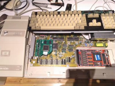

I'm new here and here is why I registered account here. Any ideas and hints?
I have a KCS Power PC board inside of Amiga 500 Computer. I have managed to add hard drive to it and it works just fine. It has a 10mhz 8086 CPU and it uses Amiga's video and ports.
http://amiga.resource.cx/exp/powerpc
Currently only way to transfer files to hard drive, is 720kb disk images. It (Amiga) has a Gotek installed as a disk drive.
I have tried to transfer files over serial without a luck. I can make a connection and read file / folder lista, but transfer always ends up to CRC error.
I have 100% working cable, as I can use it with Amiga side. Software I have tried is File Maven 3.5. I have tried to use DosBox, VMware virtual machine and Windows XP 32bit.
Any Ideas better software or what should I do? I have increased COM buffers, tried different handsakes etc.
