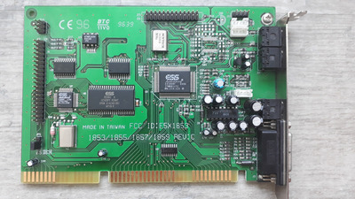

Hi. I would like to share with you the project I've been working on for some time now. Since I have discovered there is a ES982 wavetable chip which was used mainly in old Compaq laptops I wanted to dump it a try to use it with some of the many ESS sound cards which have room for wavetable chip. I have acquired the 2MB chip and successfuly dumped it, then built a programmer which can flash pin compatible MX29F1610 EEPROMs for use with the cards. Few days ago I tried to populate two of my BTC 1853 sound cards but sadly, they don't work. All I get is crackling right after initializing the card. It's weird since I have followed official ES690 schematics, the only thing I did differently was use of 33.8688MHz crystal instead of 33.000MHz (I couldn't find any). To my knowledge that shouldn't be a problem.
If there is anyone who would like to participate on the project I would be very glad. In the end, I would love to make the project available for anyone in the future so everybody would be able to build such a card for cheap. Right now I'm stuck and don't know what to do next. I have order a DIY kit to measure the crystals to be sure they're of the right frequency but the problem is probably elsewhere. Who knows, maybe I got the dump bad. After all, I had only one of the ES982 chips at disposal.

Reply 1 of 70, by Tiido
33.868800 will produce a slighly off MIDI UART freq which can result in no MIDI signal getting received by the chip. Proper MIDI freq is 31250 baud but 33.8688MHz will give 32072 baud.

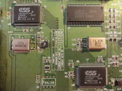

Reply 2 of 70, by Paar
There is an ES689F based card with ES981P wavetable ROM which uses 33.8688MHz crystal. I don't own such a card but I have found a picture of it. So I assumed it would work fine. Of course it doesn't mean the same applies to ES690F but I do have ES689F based card with 33.000MHz crystal. So I think ES690F have same specs as ES689F but adds reverb. Unfortunately I cannot find detailed data sheets for ES689 to confirm it.

Reply 5 of 70, by Tiido
I just got 33.8688MHz tested and the card works fine with it, so the problem must be elsewhere...
Things look like they are connected properly as far as the new signals go. It could be that the dump you made failed because of a badly connected pin or something. I have had to fight that a lot, taking many reads (with removal of socket between them) and comparing them to make sure I have matching dumps. More often than not I have differing reads...
EDIT: Where is the !CE line of the ROM going ? There's no separate !CE signal on ES690 datasheet that I could see, only on ES689. I would image it needs to be also connected to GND for proper operation so that data is always available.

Reply 7 of 70, by Paar
Checked the card and it seems the CE pin of the ROM chip is connected to A20 pin of the ES690F. Perhaps a mistake in datasheet as there is no need for such a pin? Checked another card which has a place for both ES689 and ES690 and the ES690's A20 pin is connected to ES689's CEB pin.
Tried to swap crystal for another one (in fact tried two others), then tried to replace ES690 chip for another one. At first I couldn't hear a thing when playing MIDI music,even though the tested software behaved like something is playing. So I tried to replace MX29F1610 with the real ES982A MASK ROM and the result was the same. Did a reflow of both ES690F and ES982A and after that crackling occurred again after initializing the card. It's weird.
Concerning the ES982A chip - at first I made a dump with TL866 programmer. Since TL866 cannot be used for programming MX29F1610 chips I had to build a new one designated for those. Tried to dump the ES982A again with this new programmer and the dump was the same. So either the dump is good or the chip has been damaged somehow during desoldering process. Maybe it would be a good idea to get hold of another one but finding it is a real pain. I have one possible source though which I can try. Is there a way to validate the dump? I know someboy on Vogons unpacked the 1MB dump, maybe we could try to do the same with the 2MB one.
EDIT: Checked the schematics and it's true one has to connect ROM's CEB pin to ES690's A20. It's a weird solution nonetheless.
