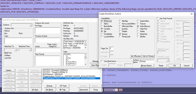

One more issue:
IDirectDraw7::CreateSurface
with
DDSD_BACKBUFFERCOUNT | DDSD_CAPS
DDSCAPS_3DDEVICE | DDSCAPS_COMPLEX | DDSCAPS_FLIP | DDSCAPS_PRIMARYSURFACE | DDSCAPS_VIDEOMEMORY
leads to:
[dgVoodoo] ERROR: DirectDraw (0BDB9848)::CreateSurface: Invalid caps flags for a plain offscreen surface. None of the following flags can be specified for that: DDSCAPS_MIPMAP, DDSCAPS_COMPLEX, DDSCAPS_FLIP, DDSCAPS_OPTIMIZED.
Is this correct?

Well. Looks like this is correct error. Just tested this flags combination in DX SDK7 Ddraw Test application and got DDERR_INVALIDPARAMS. At least modern DDraw implementations works this way.

vedmysh wrote:
IDirectDraw7::CreateSurfacewith DDSD_BACKBUFFERCOUNT | DDSD_CAPS DDSCAPS_3DDEVICE | DDSCAPS_COMPLEX | DDSCAPS_FLIP | DDSCAPS_PRI […]
leads to:
Are you sure? That's a perfectly valid cap flag combination, describing a primary surface. I gave it a go in my test app

Reply 10 of 21, by vedmysh
Well, I am using dgVoodoo in cooperation with dxWnd. It is possible, that dxWnd under the hood change the flags. But the information about the flags i got from two sources - dxWnd debug messages and rohitab api monitor. I will investigate the problem and let you know if find something usefull.
Also, as i said before this flag combination lead to an error in SDK test tool (on "native" ddraw(ms ddraw.dll) "wrapper" in windows 10). Screenshot attached.
Confirmed - the root of the problem is in the dxwnd. It replaces some parameters later and then call dgVoodoo.

Guess Sleep(1) will help easily identify the source fragment.
Dege, maybe you have any ideas about this?
May i ask you to include pdb files in your releases?
Thanks in advance.

vedmysh wrote:
BTW, this tool (DX7 SDK test application) crashes with dgVoodoo after "connection" (DDraw creation).
Yes, I know. That app fumbles directly for data in DDraw objects, at binary level. So it's not complatible with dgVoodoo. I didn't want to have binary layout compatibility with MS ddraw just because of this app.
vedmysh wrote:
Dege, maybe you have any ideas about this?May i ask you to include pdb files in your releases?
That code is the shader compiler thread(s) which aren't utilized starting from 2.61, it's just there in a waiting state.
For memory corruption, did you try Application Verifier?
Do you have other dgVoodoo module loaded in the process in addition to ddraw?
Pdb files would require a dev release of the dlls (in the dgvoodoo api package).
