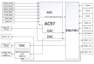

Here I show Live's simplified scheme:
The attachment 10k1.jpg is no longer available
For boot mixer type ekm -b or ekm -boot. As default mode there are working analog front, analog rear (+SPDIF3), analog center/sub, and there is AC97 input disabled.
If you type ekm -boot -d all analog out lines will be disabled and CEN/SUB out will be switched to digital out.
Then type command ekm -c > filename.ext with any filename and you'll create config file. It has text format, please see readme. For the future regular boots you don't need along a -boot key with default parameters. Just edit them in your config file and place in autoexec.bat the command ekm -f filename.ext. [Be sure the program runs in the current directory or in one of PATH-directories.]
Known bugs: in config file created by a program there are incorrect levels on REAR and SPDIF2 outputs (-2147384638 or so). Just change them to 100 (or less as you wish 0-100).

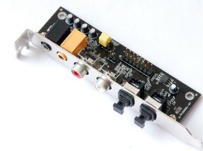

I use this bracket
The attachment $_3.jpg is no longer available
for connecting CD IN and AUX IN to 3.5mm jacks and for connecting SPDIF contacts on 40-pin header to RCA COAX + TOSLINK.
