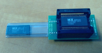

I digged one ISA soundcard with ESS 1869F, ES690F and ES981P. I would like to try this mod but where to get the flashrom MX29F1610 or some other that can be used? I have one AM29LV160DB in compatible SOP package but unfortunatelly it's 3,3V only device, most of such flashes I have are tiny TSOPs...

Getting ICs is not that hard. However getting a compatible programmer is another issue. Do you have the means to flash those ICs?
Reply 48 of 71, by RayeR
I have ELNEC Labprog48 that can handle thousands of chips 😀 But I don't have SOP-DIL adapter so I'll have to do some wiring or make a simple PCB... BTW nasel jsem to pres tve vlakno na high-voltage.cz ale tam skoro nikdo nechodi a nikdo nebastli 😀

Please check if a SOP44 to DIP44 Adapter can be used with your programmer. They are very cheap. I got mine from Ebay for approx. 7-8 Euros. And I can say that programming a MX29F1610 works with such an adapter with my programmer. The MX29F1610 are the perfect fit for this project. YOu just have to connect pin1 and Pin23, then everything will be fine.
Reply 52 of 71, by RayeR
Do you mean some adapter with ZIF socket or that when you need solder the chip? I will do programming only once and then I will propably have no further usage for such adapter so I can simply use flat cable or such improvisation...
I mean such an adapter: https://www.ebay.de/itm/404236321834
You'll never know if you need it again!

I ordered the ZIF socket from AliExpress too. It arrived today together with 2 FlashROM chips. Quite decent quality of the socket for such low price.
So I'm ready to flash it and do the mod 😀

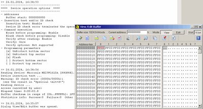

I tried to program one flash chip and repeately getting
Warning: ID check error (0000h/0000h)!
and memory reads all the time FF00h value. Insertion test passed so it's not a bad contact. When ignored ID error it cannot be erased, obviously...it seems damaged chip.
The second one was erased, read ID properly and programming was successful. Simply chinese 'quality', probably some recycled/waste chips...

I tried again to day but now way, 2nd chip is dead. I opened dispute on Ali...
