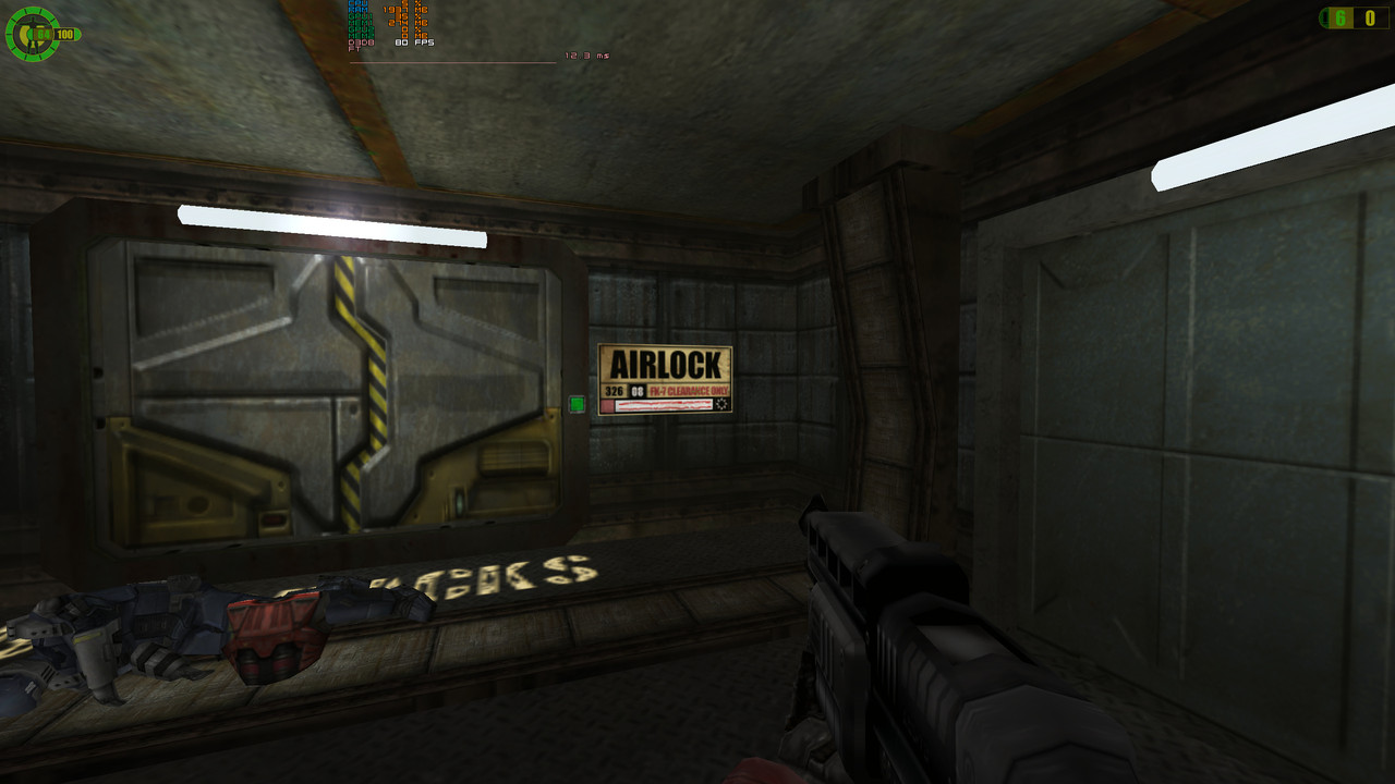

Fast Memory Access really does magic about performance in Pariah!
One issue about Pariah (and maybe other UE 2.x games): I set 75 Hz as desired refresh rate in the ini file (now that I got a beautiful 75 Hz IPS monitor 😁 ) but dgvoodoo2 enforces 60 Hz ! No issue with Crosire Wrapper (but it can't handle the game "advanced" - 🤣 - shaders).
EDIT: UT 2004 has the same problem, as expected. You can "solve" it by forcing resolution and refresh rate but still it needs come fixing (if possible).
Always in Pariah Phong shading forcing results in black terrain textures (bumpmapping? cubemapping? texture format?) but this is a well know old issue.

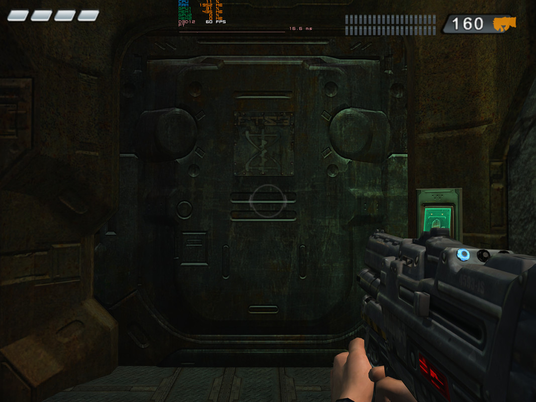

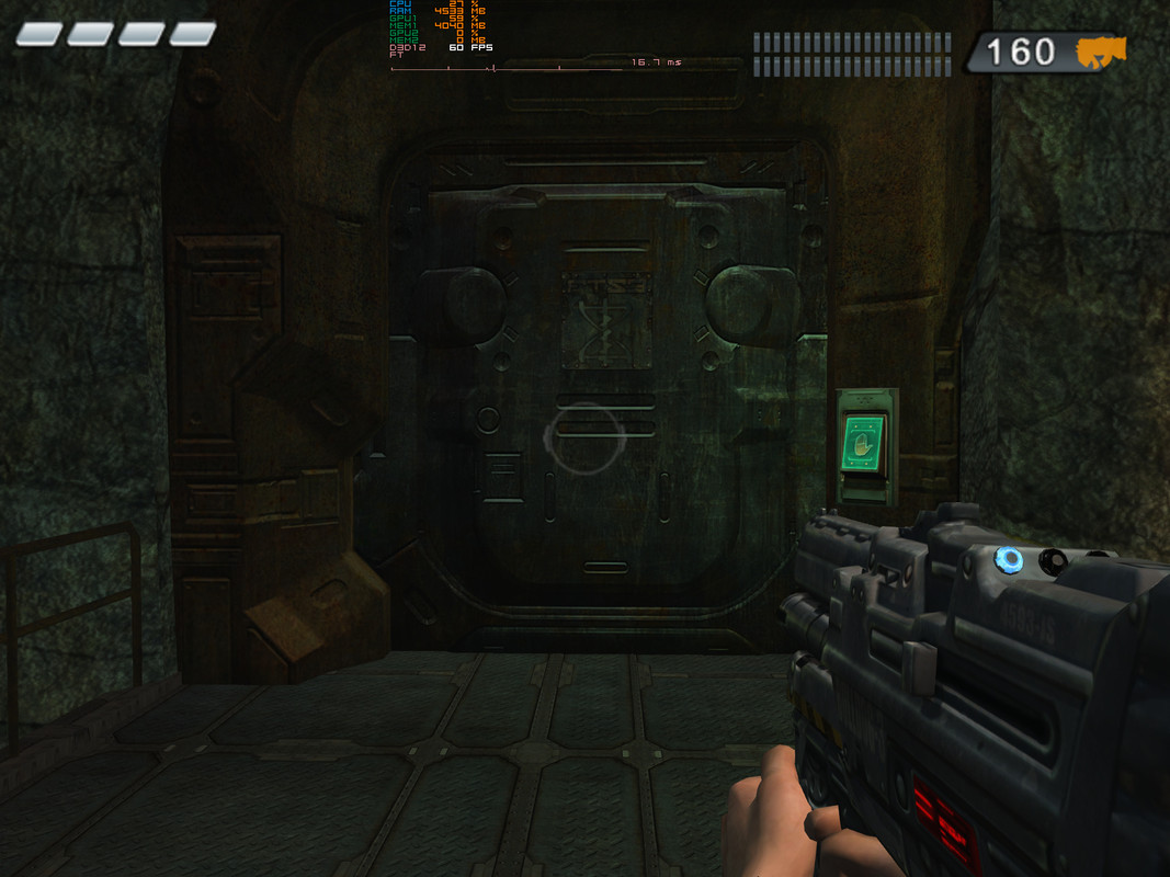

Big video memory (and memory?) management issue (in DX12 only?):
1) after some seconds of gameplay
2) after some minutes of gameplay
Well, 400 MB -> 4000 MB.....

There's clearly a memory leak, I see with my own eyes the VRAM usage going from 3300 MB to 4030 in a bunch of seconds on a 4 GB VGA (1050 Ti). With and without HW GPU Scheduling.
Reply 126 of 474, by Squall Leonhart
Direct3D 12 will try to retain video contents in vram, and the reading from rtss is basically faulty data for vram allocations because it measures Committed Total of all processes, not process dedicated.
Reply 127 of 474, by lowenz
Squall Leonhart wrote on 2020-09-10, 09:23:
Big slowdowns I encounter - and VRAM usage is topping the VGA maximum - are not "faulty readings".
No issue (the slowdowns) in D3D11.
