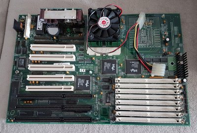

Hi. Is this motherboard good for Pentium Pro build?
Reply 1 of 19, by mpe
I can't see why not. Reputable brand (Tyan), Socket 8, 440FX chipset, standard form factor, coin battery. Looks like a very nice board!
It is.a pity that the second CPU socket isn't present.

I want to build ultimate pentium machine, i have dilema betwen single pentium pro 200 vs dual pentium 200

what do you think guys, is a chance to solder second socket 8 and it will work?
It's possible, but you also need to install a VRM connector and a VRM in it next to the unpopulated socket, and also it would be preferable to have a board with both sockets populated to see which components could be missing.

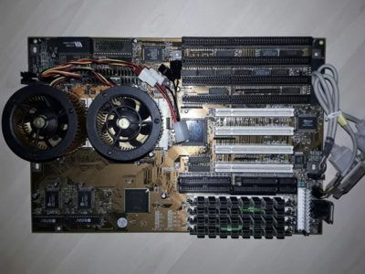

i have this motherboard with 2x Pentium 233 MMX
Reply 12 of 19, by red-ray
Nice setup, which motherboard is it and what is the winbond chip between the PCI slots and the USB cable ?

its SMP Soyo 5TH10 (intel 430HX)
Then that's pretty ultimate for So7 Pentium.
Question remains which OS and applications you intend to run - as SMP needs WinNT or better, and no games from this period use the second CPU.
