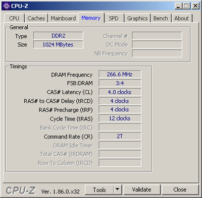

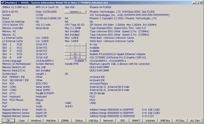

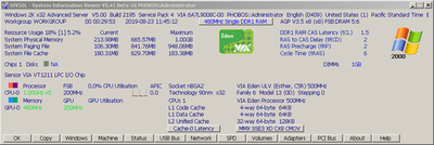

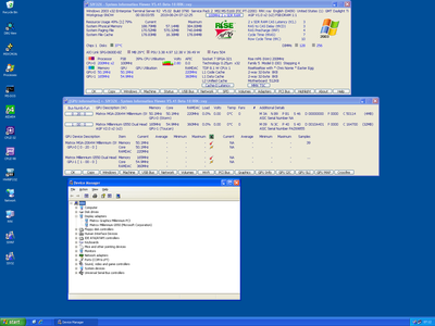

Reply 9 of 1037, by xjas
I tried it on my ComputerLab ST5500 thin client. Everything seems to work, but SIV disagrees with CPU-Z on whether it's a DDR1 or DDR2 system.
25.71 KiB
42083 views
12.55 KiB
42083 views
I'm pretty sure CPU-Z is correct here.
This is a very compact thin client; I haven't opened it up to verify this, because that requires breaking plastic tabs, but I'm pretty sure the RAM is soldered onto the mainboard (no SODIMMs.) Note that the CPU-Z 1.89.3 x32 beta in the other thread also has trouble reading this system's RAM info but 1.86 has no problem.
Also, the CPU is reported as a "VIA Eden 500MHz" running at 1GHz (5x200). I think this is a problem with the CPUID as it happens in everything, including CPU-Z, Windows's device manager, and Linux's /proc/cpuinfo.
Full report here:
SIV_PHOBOS.7z
90.15 KiB
276 downloads

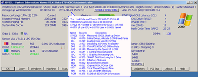

Reply 10 of 1037, by red-ray
  1. Thank you for checking out SIV and your excellent post. I have adjusted SIV, there is now a 5.41 Beta-17 and I noted:
  2. You are correct in that it should be DDR2 and Beta-17 should get all the memory timings correct. Note CPUZ fails to report tRFC.
  3. SIV failed to read the DIMM SPD data and Beta-17 should, does it?
  4. If you hover the mouse over the date/time on the 2nd line SIV will report how long it took to read the SPD data which I suspect will be rather faster than CPUZ, is it?
  5. Looking @ [Machine] the BIOS reports 1GHz, comparing the SIV CPU benchmarks for my VIA C3-M (Nehemiah, C5P) @ 800 MHz and your system I am pretty sure it's running @ 1GHz.
Please will you try Beta-17 and post both SIV_PHOBOS.txt + SIV_PHOBOS.dmi. The .DMI is a binary dump of the BIOS which contains the data reported by the [Machine] panel and SIV works better in test mode when I have it.
file.php?mode=view&id=67344&sid=a5da970d6c1131708659fd5f4d0c8934
    67.11 KiB
    42053 views
    SIV Beta-17 screen

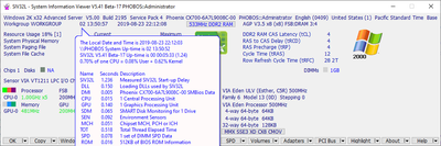

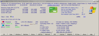

Reply 11 of 1037, by xjas
No problem! I tried the new build and it seems to be working fine; it detects DDR2 & reads the SPD correctly. SPD read time was 0.766s (CPU-Z 1.89 hangs there for at least 15s.)
26.15 KiB
42036 views
28.98 KiB
42036 views
29.61 KiB
42036 views
Updated report (including .DMI):
SIV_Phobos Beta17.7z
245.07 KiB
252 downloads
I've done a couple other machines that might be of interest but I'll make a new post for them shortly. BTW big thanks for still supporting these old machines with your program, it's a really useful tool to keep around.

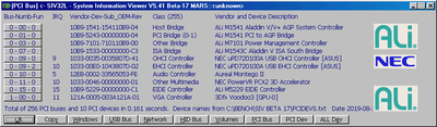

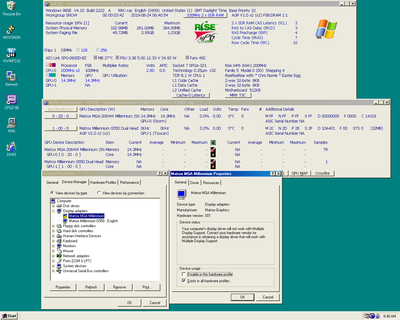

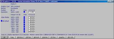

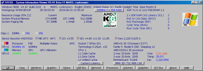

Reply 12 of 1037, by xjas
The other two I've done so far are my Shuttle XPC (Geode NX1750+Geforce3) and K6-2/500+Voodoo3+PowerVR, both running Windows 98 (so no detailed machine info, sorry...) Here's what I got:
K6-2+Voodoo3:
29.18 KiB
42033 views
16.86 KiB
42033 views
18.46 KiB
42033 views
23.17 KiB
42033 views
Everything seemed to read fine on this one, including identifying & detecting the clocks on my V3 correctly, although it doesn't seem to get much more else from the card.
The PowerVR PCX2 (Matrox M3D) in the system was not detected as a "GPU" but does show up in the PCI device listing. This is a dedicated 3D accelerator that does not have a video output, it communicates with the primary card (V3 in this case) over the PCI bus. Not sure how SIV handles multiple GPUs but just noting this in case it's useful.
System report:
SIV_MARS.7z
37.47 KiB
252 downloads

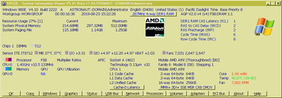

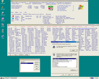

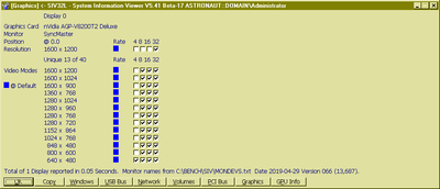

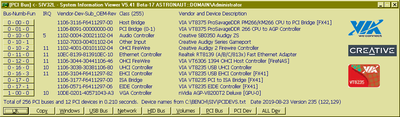

Reply 13 of 1037, by xjas
Shuttle XPC (Geode+Geforce 3):
Note: this system is running 98SE with KernelEX installed (the K6-2 doesn't have it.) Not sure that makes any difference. This is also a less "pristine" system meaning I've had it for a while & have swapped around graphics & sound cards/drivers a bit.
24.85 KiB
42031 views
26.62 KiB
42031 views
14.07 KiB
42031 views
Everything seems correct. It identifies the Geode NX1750 CPU as a "Mobile Athlon Thoroughbred", which is more-or-less the same thing... I'm not sure it's even possible to differentiate this model of Geode. The BIOS POST calls it an "Athlon 4 XP-M."
It doesn't identify the GPU on my GeForce 3 Ti200, although it does report it as an ASUS V8200T2, which is correct. It can't seem to read much info from the card.

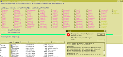

When saving a report I get a crash at Section 103 [menus]. This happens every time, including on clean boot.
36.45 KiB
42031 views
System report:
SIV_ASTRONAUT.7z
36.13 KiB
260 downloads
Let me know if you need any further info from these.
I also have another thin client running a 533MHz VIA C3 on a variant of the PLE133 chipset. If it helps I can try a run on that system too.
Reply 14 of 1037, by red-ray
xjas wrote:
BTW big thanks for still supporting these old machines.
Thank you for checking things out and all now looks to be OK. The SIV start-up time is rather longer than usual which I think is down to the speed of the D: flash drive.
BTW the system seems to have a SO-DIMM with the AD2SHH1GS1WB-6EGE part number. When the memory is soldered onto the board I have never seen any SPD data. It does not report the manufacturer.
I suspect if you start CPUZ when SIV is active then SIV may whinge about this and if you watch Menu->Help->Lock Handle you will notice CPUZ holds the Global\Access_SMBUS.HTP.Method for an excessive time (> 1 second). Given SIV can read the SPD data in 0.766 seconds then I can't see why CPUZ can't.
I will look forward to seeing how SIV does on your other systems and hope there are no lockup issues.
Reply 15 of 1037, by xjas
^^ yeah, drive D is a really slow USB stick. C: is only a 1GB IDE flash & is mostly taken up by Win2K so I make do.
Reply 16 of 1037, by red-ray
xjas wrote:
Shuttle XPC (Geode+Geforce 3): […]
  1. Note: this system is running 98SE with KernelEX installed (the K6-2 doesn't have it.) Not sure that makes any difference. This is also a less "pristine" system meaning I've had it for a while & have swapped around graphics & sound cards/drivers a bit.
  2. Everything seems correct. It identifies the Geode NX1750 CPU as a "Mobile Athlon Thoroughbred", which is more-or-less the same thing... I'm not sure it's even possible to differentiate this model of Geode. The BIOS POST calls it an "Athlon 4 XP-M."
  3. It doesn't identify the GPU on my GeForce 3 Ti200, although it does report it as an ASUS V8200T2, which is correct. It can't seem to read much info from the card.
  4. When saving a report I get a crash at Section 103 [menus]. This happens every time, including on clean boot.
  1. Thank you for the report
  2. OK
  3. Looking @ Menu->Hardware->CPUID->CPU-0 I expect this is as good as is possible, does CPUZ report the same?
  4. For NVidia GPUs SIV uses NVAPI and your GPU is too old for NVAPI to support it. If it was an NT system SIV should report the GPU chip.
  5. I suspect this is down to a bug in KernelEX as I have never seen this before. Do Menu->File->Save->Save Selected and deselect [menus] before pressing [Start].
  6. If you uninstall KernelEX do Menu->Help->View Menus and/or saving [menus] work OK?
  7. Which version of KernelEX do you have and where can I get it from so I can see what happens on one of my systems and try to adjust SIV.

Reply 17 of 1037, by red-ray
Thank you for the report and this is the first time I have see SIV report Voodoo 3 clocks 😎 AFAIK there is nothing else that could be reported.
The NEC PowerVR PCX2 3D Accelerator is an Other Multimedia so is not really a GPU unlike the 3Dfx Voodoo3 which is VGA Controller.
On NT systems SIV does support multiple GPUs, 8 by default and -GPUS=<N> can be used to support more. Multiple should work on 98 and I got as below when I tried it, notice how SIV does rather better on 2003
    163.43 KiB
    41962 views
    2003 with two GPUs

Reply 18 of 1037, by red-ray
I installed KernelEx v0.36a and it's OK on my system, which version do you have installed?
I was planning to use the remote debugger to look into this, but as I don't see the issue can't, do you have MSVC 6 and know how to use it please?
    77.26 KiB
    41961 views
    [menus] OK with KernelEx v0.36a
