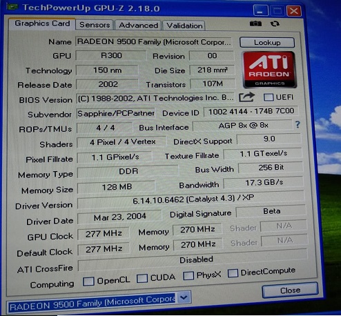

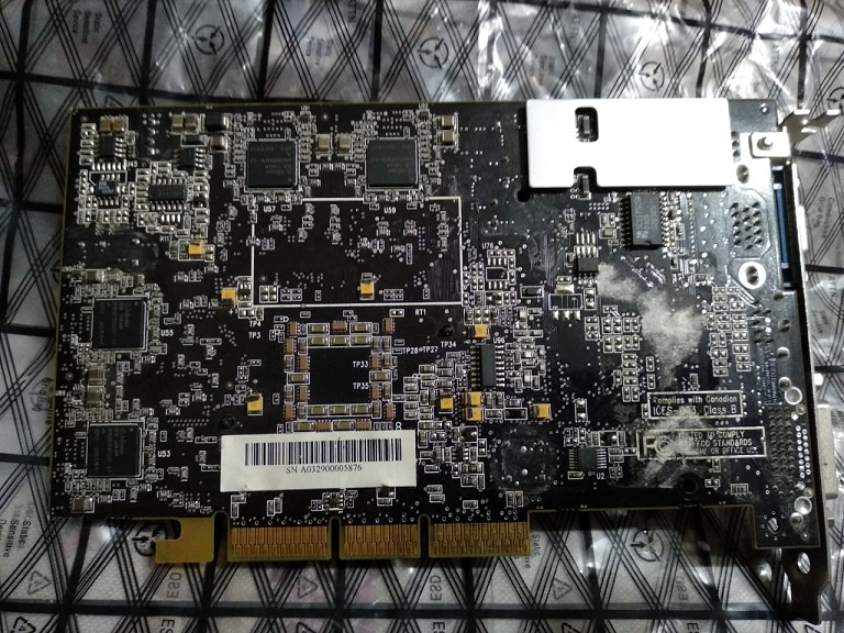

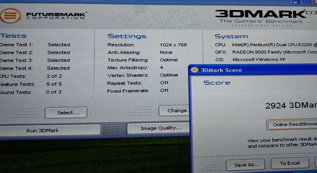

Yesterday i was buying a really nice ati videocard very cheap, i thought i was getting a 9800SE model, but it was really hard to find an image on google that matched exactly the pcb color and the shape of the corners of the heatsink. So i came home with the card, installed everything and windows detected it as an ATI 9500..... and then I remembered that there was an era in PC history where manufacturers actually used the same PCB and parts from lower end models as the higher end models, so people using soldering and cable mods and pencil mods transformed some of tha ati cards into higher end models. ( I never understood the pocess since i never had one of those ati cards back then i used lower end nvidia models)
i wonder if this card can be modded or not.

Regarding the Radeon 9500, the mod was a simple(ish) bios mod, early 9500 (non pro, the pro was a different chip) used the same chip and PCB as the 9700 (pro) and could unlock to a full 9700 (pro) card.

That 9500 looks like it's using the 9700 PCB, so it might be unlockable. The simplest way to check would be to install Omega drivers from back then, they had the option of unlocking 9500, 9800 SE and later also X800 GTO cards.
