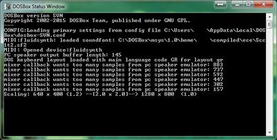

ANOTHER UPDATE: I found out that adding
1#define C_FLUIDSYNTH 1
to config.in after compiling and before making my build obviously results in an exe file at least trying to use the fluidsynth driver. It first asked for all the dependent dll files (libglib-2.0-0, libgthread-2.0-0, intl), so I copied them all in the DOSBox directory. But the exe crashes every time I start it. 😵
AND ANOTHER UPDATE: I tried compiling and using a shared fluidsynth library. This looks promising! 😊
The attachment dosbox_ece_with_fluidsynth.jpg is no longer available
I don't have any idea why it asks for this file on your machine. I just tried my build on a completely new install of Windows 7 in a VM and it ran right from the start without asking for any other DLLs. I even searched the entire HDD for this file to make sure it isn't installed. So the problem doesn't seem to come from DOSBox. Maybe you already have another version of any of the provided DLLs installed that is looking for a libiconv-2.dll? Just in case, I'll attach the file it is looking for, just copy it in the DOSBox directory where you extraxted my build into.
