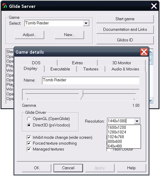

I started to use Glidos for playing Tomb Raider, and found out, that there is bad support for wide screen formats. Big wide screens become more popular and popular (with 16:10 and 16:9 angles), but Glidos offers only limited choice of old screens, or 1600x1200, what is "normal" screen with 4:3 aspect ratio, but unfortunately I cannot use this resolution on my monitor.
My wish is, that Glidos should have support for screen formats 1680x1050 and 1920x1080. I have tried to enter those resolutons manually, but OpenGL mode refuses to open this resolution, or switches to 1024x768 in left upper screen corner, and Direct3D shows 1024x768 window centered to black screen. It were great, if it could use and show me whole new generation bitmaps in full glory.

Glidos just interprets the Glide commands from the game. It is still the game that generates the scene, and TR can generate only a 4:3 area. Because of this, the best that is achievable on a 16:9 screen, is to paint a 4:3 subarea, leaving black bars at the side. I have put support for that in Glidos, but it is available only in Direct3D mode. It's the setting labelled "Inhibit mode change".

Reply 4 of 19, by teet
OK, here are screenshots about what I wanna accomplish.
My screen natural resolution is 1920x1080, sp highest 3x4 resolution were (1080/3*4)x1080=1440x1080. I write it to Glidos settings window (picture 1)
Then I launch game, and get this: picture 2
What I wanna see: picture 3, Tomb Raider game with resolution 1440x1080 nicely on my screen natural resolution
Seems like entering any resolution except this ones that Glidos offers default, does not have any effect, and they default always to situation on picture 2.
What is my goal? use highest resolution available, like I had 1600x1200 screen.

Reply 5 of 19, by Glidos
Ah I see. I've made the Resolution control writable. Oops! Only the resolutions in the drop down list are supported by the Windows side Glide wrappers. If you click on 1280x1024 then that will give very nearly what you want. There will be just a thin black line top and bottom.
As you say, it would be worth adding a 1440x1080. I'll try to get around to that sometime.

Oops! I posted having read only the previous post and not the whole thread. It seems I solved the problem mentioned here some time a go, but didn't post about it in this thread. I'm pretty sure how it works now: if you select "Direct3D", "Inhibit mode change" and "Full Screen" then you'll get the largest 4x3 resolution that fits your screen mode, independently of the resolution you choose.
