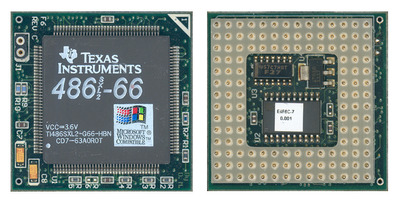

When using AHA-1542CP and PGA132 SXL2-50, I needed to set BARB to get reliable operation in Windows 3.11. DOS looked like it would work with FLUSH, but not WINDOWS. On a few occasions, I wired up a NAND gate to implement the FLUSH circuit as shown in the SXL2 databook appendix. I don't recall it making much of a difference with the ability to use FLUSH.
Once I found the Evergreen SXL2-66 upgrade adaptor, which contains a PAL with various logic, I was able to use flush reliably w/AHA-1542CP. And the Evergreen upgrade adaptor does not have a header for connecting MEMW# to ISA MEMW#. Unfortunately, I don't recall the outcome of connecting the custom PGA168 interposer for the SXL2-66. That adaptor is too tall to fit under my HDD/floppy mounting cage in this system.
Concerning the loss of performance when using BARB vs. FLUSH, I recall it being about 4% in doom, but I think that was without sound. I recall reading other testers indicating they saw a 10% hit, but I don't recall in what benchmark. This might be worth re-evaluating.

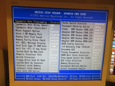

On my AMI Mark V Baby Screamer, my notes indicate that gate A20 on KBC connects directly to Vcc. Its not left open like on some boards.
https://theretroweb.com/motherboards/s/ami-ma … by-screamer-s42
I am guessing U33 chip laser etched and repainted to "Megatrends" is VLSI VL82C330. Pin 96 "-BLKA20" is the real A20 output from this chip and should be wired to Cyrix A20M input.
Chipset supports Fast A20 gate option, most likely manufactured left it permanently forced ON to not have to wire keyboard controller A20.
Other notes indicate "A20M_TST fails unless using AMISETUP to set the Turbo Switch Function to Enabled, then all tests pass... tried later to enable Turbo using AMISETUP and now A20M_TST fails... why?"

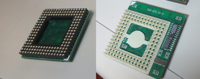

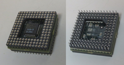

You need two gates for this to work and motherboard must not connect to CPU pin 30 (FLUSH).

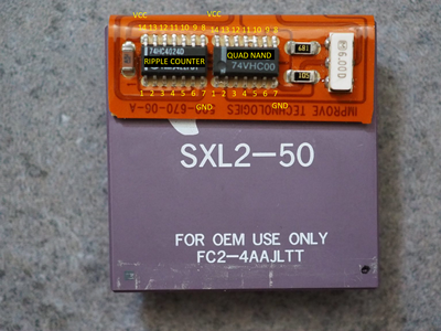

FLUSH cant work without that connection unless it just emulates BARB by flushing on any DMA whatsoever. Defeats the purpose of FLUSH mode, but I can see someone manufacturing CPU upgrade that does this to be foolproof and not require any software - if will work in any board with of without Cyrix BIOS support and regardless of enabled Cyrix options, all thanks to always working in the slowest safest mode.
If Im Kingston Technology I will probably make double super sure my CPU upgrades work in IBM computers super idiot proof during the "we need those barely capable machines booting Windows 95 like yesterday" corporate transition period 😀

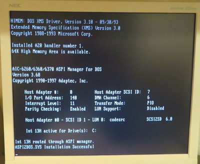

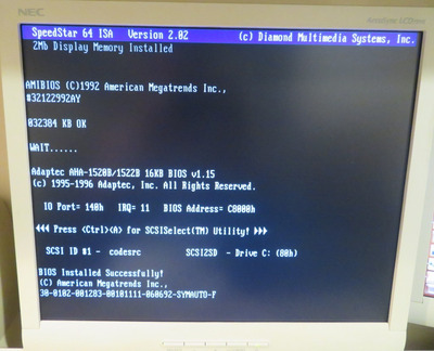

I'm normally running the Adaptec DOS driver and ESS sound drivers in DOS, plus HIMEM. Nothing fancy. "Windows makes problems"... well, each motherboard behaves differently, and it has been over a decade, so I cannot really offer specifics without testing everything again. My memory of late isn't great. I swore that in my Adaptec box I had an AHA-1540CP (no floppy). I open the box today to pull out the card, and voila, it is the AHA-1542CP (with floppy).
It is not possible to disable DMA on the AHA-1542CP.

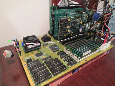

On the testbed now is my unbranded Symphony 461/362 based motherboard. I did find a sticker on it with a giant "GEM", perhaps that is the brand. I will assume it is for record keeping purposes. This motherboard is:
GEM MB386-40-SYM
256K L2
32 MB 9-chip, 60 ns DRAM
85 MHz crystal oscillator
ISA = 85/2/4 = 10.625 MHz
BIOS is from a DTK PEM-4036Y because it is the best for HaydnII boards
all my DOOM w/sound tests are performed with the mouse enabled
"van der meer" pins on PGA132 socket:
FLUSH# not connected
LOCK# not connected
A20M# not connected
ADS# 10K pullup to 5V
BIOS has an "enable L1 option", which on most boards, merely sets L1 to enabled, but leaves the entire 4GB uncacheable. On this board, that's not the case.
Upon booting to DOS without touching cyrix.exe, cyrix -q indicates this:
1A20M input enabled 2KEN input disabled 3FLUSH input enabled 4BARB disabled 5L1 enabled via CR0 664k of each 1MB set cacheable 7640K-1MB set cacheable 8 9Non-cacheable regions set: 100x000A000 128K 110x000C000 256K
AHA-1522B (non-bus mastering) CPU MEMW# is not connected to ISA MEMW#
The only cyrix command I needed to type was cyrix -cd to clock double. DOOM w/sound = 3689 = 20.25 fps (FLUSH# enabled)
if I disable FLUSH# using cyrix -f-, then DOOM w/sound = 20.25 fps (the same). How? if I test without sound, then DOOM w/out sound = 3370 = 22.16 fps

Next, I connect CPU MEMW# to ISA MEMW# with a wire. FLUSH# is set to enabled. The performance drops 11% Why? DOOM w/sound = 4091 = 18.26 fps

I must disable Internal Cache in BIOS to even boot. Trying to enable L1 manually in DOS, the system hangs. For the system to function, I must disable FLUSH# and enable BARB. Upon which:

Next, I wire CPU MEMW# to ISA MEMW#. With this wire, I can now use FLUSH# and disable BARB, upon which:
DOOM w/sound = 4090 = 18.26 fps (FLUSH#), or an 8% benefit compared to using FLUSH# [when CPU MEMW# is wired to ISA MEMW#].

I'm not certain that Megatrends on the AMI Mark V Baby Screamer is the VL82C330. This was a theory, but I couldn't get any MRBIOS for the VLSI 330 series to work on this motherboard. Megatrends may be AMI's own chipset based on the 330. I don't know.
Doubt it, but that can be verified further since thankfully there is 330 datasheet available.
1 CRIME CRIME!!!!! As mentioned above there is no CPU MEMW pin! wiring ISA MEMW to CPU W/R is highly illegal. Straight to Jail!Edit: was looking at wrong CPU package
2 Im guessing BARB is disabled here. 3 and the answer is dont know because this is Undefined State! Those signals should never be linked with each other!Edit: was looking at wrong CPU package
Next, I wire CPU MEMW# to ISA MEMW#. With this wire, I can now use FLUSH# and disable BARB, upon which: DOOM w/sound = 4090 = 18.26 fps (FLUSH#), or an 8% benefit compared to using FLUSH# [when CPU MEMW# is wired to ISA MEMW#].
Hmm. Lets think about this undefined state. MEMW linked to CPU W/R might force CPU to think there is a write to ram every time there is a write on ISA bus that somehow lines up with CPU reading its W/R pin. x86 CPU bus is synchronous and W/R pin will only be probed at certain cycles. The only ISA Writes happening during Doom should be to VGA ram ... and disk access when bus mastering. VGA ram should not be cacheable anyway plus its the CPU itself doing those writes. How Bus Mastered disk accesses leak to the CPU is a big mystery because during DMA cycles (HOLD/HLDA) CPU floats thus disconnects completely its address bus and W/R pin. Its all very WTF.Edit: was looking at wrong CPU package
AHA-1542CP needs CPU MEMW# jumpered to ISA MEMW# for FLUSH to function

Last I checked, read/write floppy access works fine on AHA-1522B on this GEM motherboard without BARB. If you have a particular floppy test combination you wanted me to try, I will try it out.
If the L1 cache doesn't invalidate on this board at all, then wouldn't it be crashing all the time? I've not had any issues with this board. I can read/write floppies in Win3.1 and play audio files, load old webpages, etc.

It's usually a hang on shutdown from W31 to DOS, whereby the C: prompt doesn't appear.
That does sound like a place where A20 might be fiddled with, or something to do with AHA-1542CP BIOS. Does this happen with different CPUs? Regardless of "-m-" or "-m"?
And using IE5 on the Mark V also causes disk corruption
Weird. Disk corruption would imply something going wrong during writing to disk, but L1 cache is write thru so ram always has the current state. Only happens with L1 enabled? Might be unrelated to Cyrix.
When using the AHA-1522B (no MEMW# connection), I can execute several DOS programmes from floppy in succession without issue (tried up to 4). DMA_TST provided by Cyrix always passes. It uses the floppy drive as the DMA check.
What mechanism is invalidating the L1 cache when the FLUSH# pin on MB is not connected, when MEMW# isn't wired, when BARB isn't used, and when not using an Evergreen interposer with PAL logic?

As I recall it, with the AMI Mark V Baby Screamer, the hang on shutdown (C:\ doesn't appear, but the screen still goes to a black DOS screen) happened regardless of -m-. I used to run the system with -m- to disable caching 64K at every MB boundary. I switched to disabling caching of 64K after first 1 MB only about a year ago. Do you think adding X0,64 will help the hang-up? Did you say that all systems with DLC/SXL need to disable the first 64K starting a 0 MB?
The issue with IE5 on the Baby Screamer... it has been at least 7 years since I played with this, but I recall that when IE5 would hang (about 1 in 3 tries), I was forced to shutdown by ctrl-alt-del or reset button. Upon rebooting, the system.ini file or config.sys file would be corrupt, sometimes with garbage characters, or somethings with spaces in the text where there shouldn't be, or the bottom of the page erased. I don't know if the corruption only occurred with L1 enabled because I didn't try it without L1. The system will run too slow loading IE5 without L1.
Something curious, though (Baby Screamer still)... the SXL won't clock double if I have more than a 66.6 MHz crystal oscillator installed (AHA-1540CP). Or it could go up to 72 MHz with AHA-1520B installed. That system also has a unique clock-doubled FPU installed, the ULSI DX2-66. I'm not sure if any of this is related to the IE5 hang-ups, but it points to the oddness of this system.

I can confirm that, as with the Baby Screamer, on the GEM MB386-40-SYM, I can correctly use the Evergreen QFP SXL2-66 and run DOOM w/sound, read floppy, etc, all without BARB or MEMW# wired (AHA-154xCP). I must have the FLUSH# input enabled via cyrix -f. Doom w/sound = 20.13 fps. Similarly, with this Evergreen PGA132 to PGA132 interposer, which just contains a PAL, I can also run without MEMW# wired and use FLUSH#. Result was also 20.13 fps. These two boards are shown below:
The attachment TI486SXL2-G66-HBN.jpg is no longer available
The attachment Evergreen_PGA132-PGA132_SXL2_interposer.JPG is no longer available
I can also use this Improve-It PGA168 to PGA132 interposer w/AHA-1542CP and no MEMW# wire, but the score is not very good. DOOM w/sound = 16.94 fps, which is consequently the same score achieved when using BARB. However, I confirmed that BARB was not enabled and FLUSH was. Even if I use the AHA-1522B, I still get 16.96 fps using this the Improve-It interposer. This interposer is shown here:
The attachment Improve-It_PGA168-PGA132_SXL2_interposer.JPG is no longer available
The Improve-It interposer contains the same circuit as commonly found on this SXL2 upgrade (photo taken by MikeSG in SXL2 thread):
The attachment p4050931-lines.png is no longer available
with AHA-1542CP? only explanation would be mobo properly driving FLUSH pin E13. Without AHA-1542CP sure as there is no DMA writes during Doom test.
That sounds exactly like what I described earlier - an idiot-proof interposer doing BARB no matter what to cut down on "it crashes" complaints 😀 btw this contradicts earlier "however I haven't noticed any speed difference between Evergreen, Improve-It, PGA132, or the custom interposer (no logic) when flush is set."
only HLDA and FLUSH# pins are connected, it FLUSHes on every HLDA = emulates BARB.

That sounds exactly like what I described earlier - an idiot-proof interposer doing BARB no matter what to cut down on "it crashes" complaints :) btw this contradicts earlier "however I haven't noticed any speed difference between Evergreen, Improve-It, PGA132, or the custom interposer (no logic) when flush is set."
That is because my previous tests with this [piece of junk] Improve-It interposer were with sound disabled. With sound dsiabled, all the benchmarks read about the same. I have gotten so used to running DOOM with, "doom -nosound -nomouse -timedemo demo3" that the thought to enable sound didn't cross my mind. We do all our benchmarking without sound, but in the case of determinig cache invalidation and final performance, I can see the value in enabling sound. Maybe all 386 era DOOM benchmarks should be run sound on from now on.

The SXL2 uses 8 KB cache. It is the DRx2, DLC, and SLC which use only 1 KB. I recall having some issue with my 286 to 486SLC upgrade. I was able to get the SLC (1 KB) working, but not the SXLC2 (8 KB).

On my AMI Mark V Baby Screamer, I'm using the Evergreen QFP SXL2-66. It only has 4 decoupling capacitors. IanB mentioned he had to add a 1000 uF cap to fix the issue. Maybe I should also add a few extra 100 nF and 1000 nF caps to the PGA132 on the motherboard.

Run on a GEM MB386-40-SYM (Symphony 461 / 362) motherboard with SXL2 clocked at 85 MHz.
The readme for DRAM.COM states that it is normally safe to set refresh rate to 1000 uS, but noted that after about 250 uS, the gains are negligible. On my AMI Mark V Baby Screamer, I use DRAM 40, or 40 uS, because I was finding floppy drive access slowed down noticeably when altering this refresh rate.
Notice how the L1 cache read speed doesn't pickup to the levels when using hidden refresh, even with DRAM.COM at 250 uS.
Conclusion
From the DOOM results, all is not lost when using BARB if your system doesn't support hidden/decoupled or slow refresh. We can obtain almost identical results using DRAM.COM, that is 16.74 fps compared to 16.80 fps. However, without slowing down the refresh (no DRAM.COM), and without using hidden refresh, the results are a mere 13.58 fps. If your system supports hidden refresh and you slow the DRAM refresh rates to 250 uS, you can achieve up to 17.01 fps with BARB. Using FLUSH with MEMW#, these results go up to 18.26 fps. Skipping the bus mastering SCSI controller in favour of AHA-1522B, results go up to 20.25 fps. Or you can still use the bus mastering SCSI controller if you are using an Evergreen upgrade with some clever logic in the PAL chip to achieve 20.25 fps. My preferred approach is to skip the bus mastering SCSI controller; I don't find the system noticeably faster.
