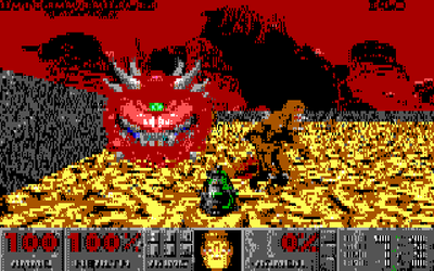

Time for a new release! FastDoom 0.9.1:
* Creative Music System (Game Blaste) music support by @Tronix286
* New EGA 160x200 (16 color) mode FDOOMEW1.EXE, fast on 8-bit ISA cards
* New EGA 320x200 (14 color) mode FDOOME14.EXE, much faster on 8-bit ISA cards compared to FDOOMEGA.EXE
* Updated FastDoom Setup program with new music devices. Support for MDA / Hercules video cards using parameter "-mono"
* New CGA ANSI from Hell mode, based on the same idea of Area5150. Base resolution of 320x100 and 16 colors. Not perfect but awesome for CGA cards.
* Add SBK soundfont loading support for Creative AWE32/AWE64 sound cards by @Tronix286. Use parameter "-sbk".
* Updated startup menu, now it only shows available WADs. Also experimental support for FreeDoom Phase 1+2.
* New command line parameter "-iwad" to load any IWAD directly
* Fixed Plutonia MAP12 crash by @Tronix286 and @RamonUnch
* Small bugfixes and optimizations

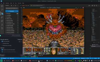

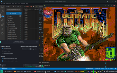

Thanks to VileR I've been able to create a new mode for IBM CGA cards: the 512 color composite mode (80x100). Still haven't tested on a real CGA card with composite output, but this is how it looks on DosBox-Staging. The resolution is too low, but OMG those colors... still can't believe this is what a CGA card can do.

Hah, nice - should be fun to see which IBM CGA model (old vs. new) produces more suitable colors for the Doom palette. Perhaps it's even possible to 'cheat' a bit by modifying the target Doom palette so it matches up better with these colors.
On real hardware it can be difficult to get reliable color output in this 'mode'... that's why 8088 MPH has a calibration screen to tweak various CGA settings and see what works best. In practice, I think we've found that maximizing the hsync width (to 0xF) gives the most consistent results, so that might be a good idea here as well.

Funny how it looks both instantly recognizable and completely unplayable at the same time 🤣

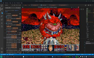

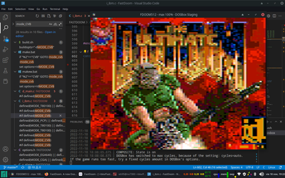

Here are two captures for the new IBM CGA models on the same emulator. Looks like those fit better for Doom than the older ones. Still have to try on real hardware, don't know why but my card won't output composite signal (no signal at all even on other modes), I have to investigate why.
I'm pretty sure optimizing the PLAYPAL + COLORMAP could get even better results on both types of cards.
