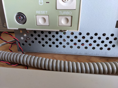

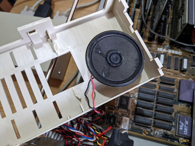

Reply 7 of 18, by Pierre32
Yep, and another option is to look at how the speaker is mounted. Funnily enough it was this very game that pushed me to fix mine. It was originally housed in a plastic cage, just hanging out there in the air. I hard-mounted it to the front of the chassis (you can see the two slightly askew screws in the second pic). Big improvement!

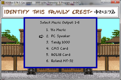

Reply 15 of 18, by NewRisingSun
There is only one non-budget version of the game. The sound card is selected via command line parameter ("adlib", "cms", "mt32", without dash or slash), or after the title screen by pressing ESC to bring up the main menu, then pressing 4 to select the music device. Sound effects will always come through the PC Speaker.
The Amiga version of the game imitates the Roland MT-32 music.
Reply 16 of 18, by Disruptor
Bondi wrote on 2022-01-23, 10:33:
Budokan has actually more sound options
This is for music output.
Sound effects are still played on PC speaker.
