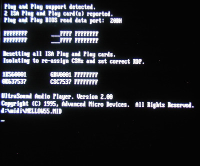

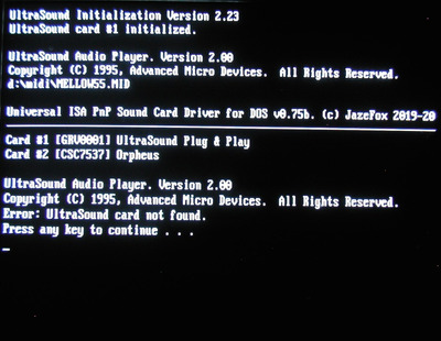

I don't like the feeling that I may have provided unjustified trouble reports, so I investigated the RDP issue further. On my system, at least, it wasn't unjustified at all, and I have some proof.
As currently implemented, UNISOUND changes the RDP regardless of the options used, even if you only ask for the list of cards. On my system, it seems to consistently set it to 263H. As previously mentioned, some vendor software does not like that. The photos I took were much more blurry than I had hoped, but they are still mostly legible. If you follow the progress of the experiment, you will see that I first use IWINIT to initialise the GUS PnP, then PLAY.EXE to play a MIDI file. Following that, I ask UNISOUND for the list of installed cards and try to play the same MIDI file again. PLAY.EXE reports that it can't find the same GUS PnP that it had just used a moment earlier. The only thing that had changed was the running of UNISOUND.
Then, I use a tool I wrote to fix the problem. It first tries to enumerate the ISA PnP cards in the system. Because the RDP is no longer correct, it gives garbage. It then issues a reset CSN command to all cards and puts them back in the wait-for-key state. That is one of the few ways to be able to issue a new RDP, which it does next, followed by going through the isolation protocol, so that the CSNs can be re-issued to the cards. Lastly, it tries enumerating the cards again, and this time it works as expected. PLAY.EXE is also able to find the card again, and the MIDI file plays normally. Photos follow:
The attachment P7280064.JPG is no longer available
The attachment P7280065.jpg is no longer available
I have also attached an archive containing the tool to fix the RDP, as well as the simple batch file that produced the output shown in the photos. If anyone wants to test and report their results, this might be useful in determining how many are affected (particularly those who had cards "disappear" after running UNISOUND). This is only really applies to systems with a Plug and Play BIOS, though systems without may have similar problems in certain cases.

Reply 204 of 697, by JazeFox
@640K!enough
Yes, you're right, I know the RDP may change with Unisound, it's a compromise I had to take one day. At first, Unisound was created without PnP BIOS in mind (486 or lower). After some versions (internal, months ago), I thought of adding some PnP BIOS detection, but I realized after testing with several different motherboards with PnP BIOS, that they implemented PnP differently (not 100% as the standard paper says) and I couldn't trust on them with the info they reported. This led into some problems (including erratic behaviour and hangups) and then tried without explicit PnP BIOS support. Just to be sure that it would be safe, I tried lots of software (vendor utils too) and didn't found one that caused problems. In fact, out from vendor INIT tools (that are supposedly not needed if you plan to use Unisound), other tools should not mess with PnP. So I had to decide: Specific PnP BIOS support or not (known problems vs potential problems I could not reproduce), so you see what I decided. In the 99% of the cases, it works fine. You found one case with issues, a player for the GUS (I'm wondering why a player need to deal with PnP???) so, after your tests I am thinking about this again. I think the best solution would be to add an eXtended command line option to Unisound to deal with this, to tell Unisound that it's running on system with PnP BIOS and then detect and use the current RDP. This way, being an optional switch, issues are reduced if the tool is run on a board with a problematic PnP BIOS implementation.
Currently, Unisound "scans" for RDP until a card is isolated, and then uses that RDP.
Anyway, after your tests, I'll make some extra little changes to the tool. To have a faster RDP scan, the tool starts at 0x263 and ends at 0x3B3, but I'll better change it to scan the whole space, starting from 0x203. That may help too.
One note about vendor tools: I analyzed dozens of them in the past and they'll are far from "respecting the rules". Some of them kills other PnP cards present in the system, some others send its own key (instead ogf the standard PnP key) indiscriminately to configure its cards (only one, not several from the same model), leaving the card in a state that couldn't be re-scanned with legit PnP tools, causing weird behaviours or hangups. Others update chip's microcode killing other PnP tools too. Even CTCU/CTCM are plagued with implementation bugs. I hope Unisound will be refined to minimize (or have zero) issues with all possible systems 😀
If you want to help, maybe you would cross a few PMs with me, if it's OK for you.
(I hope one day you would find at least one positive thing about this tool 😀)
Changes would definitely be warranted, though I'm not so sure that that is quite the right approach to start with. If you remember which systems used to cause problems, why not try the executable I attached above and see what it gives you. If it is at least able to determine a usable RDP, that may be a better starting point: scan for the PnP BIOS signature; if found, try to get the configuration structure and retrieve the RDP. Use that to scan for cards without any additional command-line options, but offer one to force an isolation scan from 203H and take the first usable port (which would be the default for non-PnP systems).
My concern is that, on my system, a scan that starts at 203H might be able to use 203H or 207H, but the PnP BIOS tends to use 20BH, so the problem would remain.
There is also the matter of configuration managers, and I am not familiar with their interface yet. Those should probably also be detected and used to the extent possible.
