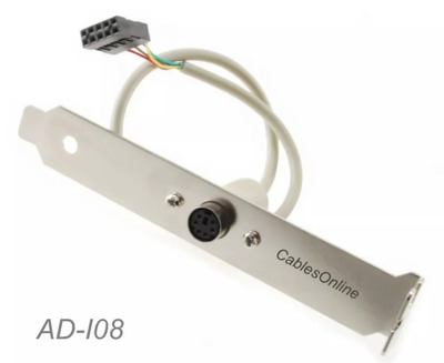

On a side note, I received the PS2 header and was able to wire it up correctly, no more serial ball mouse! The one I’ve been using is pictured below, very easy to re-wire.

Reply 27 of 272, by Disruptor
Chadti99 wrote on 2021-10-08, 08:47:
Yes. A PS/2 header is the most important thing in a gaming 486.

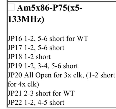

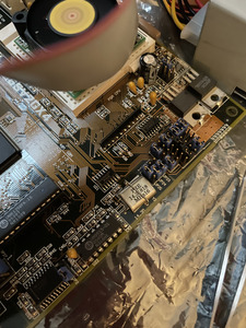

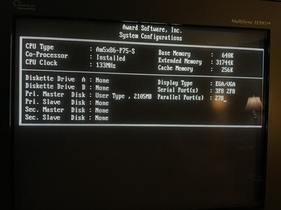

Okay, I’ve got the bios update from feipoa installed in a new eeprom. I see the jumper settings for 5x86, and what I think should be the correct jumpers for write back operation. I’m hanging just after post, when it should be initializing my hard drive. Can someone double check me? I’m assuming I should leave the jumpers off where it says “short for WT”?

This is what i got for WB L2 cache policy.
Red arrows indicate what is needed for WT.
The attachment 20211011_111824.jpg is no longer available
You probably want to do WT for better perf.

Thank you, trying now!
Reply 39 of 272, by Chadti99
Duplicating your jumper settings For WB I’m Just hanging at this screen with an ADZ 5x86 or TurboChip, odd for sure.
