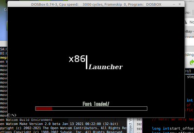

The copy from the local buffer to the (four) VESA video windows is working... but I've got a bug somewhere which is causing the offset/duplication errors.
https://www.target-earth.net
Reply 30 of 77, by megatron-uk
Aha! Another integer casting error was causing the x/y coordinate error - anything over a y coordinate of ~100 was causing the images to loop back around and get copied in to an earlier offset in the video buffer.
I think I've fixed that (as well as a similar offset calculation overflow bug in the bitmap font printing routine) and it looks to be placing elements in the correct location now, and it's clear that the RAM to Video memory copy routine is working correctly:
The attachment progress2.png is no longer available
Still some palette bugs to squash (the bitmap font should be grey outline, white fill), and some of the half-toning/antialiasing of the splash logo is not showing correctly. Definitely some palette entries not getting set correctly.
I also think I have a memory issue loading up all of the UI bitmap assets (menu bars, backgrounds, scrollfields etc). So I'm going to have to load them in and use them one-by-one, rather than keep them in-memory all of the time. 640KB should be enough for anyone.... 😀
I'm fairly pleased that other than the integer overflow and casting issues going from a 32bit world, and writing the VESA window flip code, almost everything else is working without modification. So once these few glitches are sorted it should pick up the pace quite rapidly.

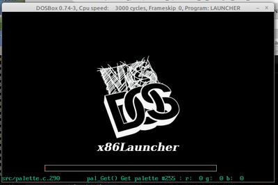

Sorted the palette mapping problem, it looks much nicer now (as well as a fancy SVG logo I converted to a 32 colour greyscale bitmap):
The attachment progress3.png is no longer available
So I figured out after setting and reading back the palette entries that they weren't getting set to the correct values... almost as if only part of the rgb triplet was getting stored... oh, wait....
normal VGA DAC is 6bit by default, isn't it?
(sound of hand slapping forehead)
So my palette setting went from:
outp(VGA_PALLETE_MASK_ADDR, 0xFF);
outp(VGA_PALLETE_SEL_ADDR, idx);
outp(VGA_PALLETE_SET_ADDR, r);
outp(VGA_PALLETE_SET_ADDR, g);
outp(VGA_PALLETE_SET_ADDR, b);
to
outp(VGA_PALLETE_SET_ADDR, r >> 2);
outp(VGA_PALLETE_SET_ADDR, g >> 2);
outp(VGA_PALLETE_SET_ADDR, b >> 2);
The line-reading bitmap display routine is also working nicely, so I'll transplant that to the rest of the ui display routines and see how we go in terms of reducing memory use. Not too far off getting the ui up and running - once we're there everything should fall in to place from the rest of the support libraries which are doing the game data scraping.
