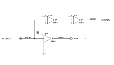

Just had a quick browse through the VT82C686B datasheet (available online). There are countless registers relating to the PCI-ISA bridge, and it might be possible that the BIOS needs to be aware of the ISA slot to set them accordingly. Aslo, less likely, but there could be some little bit of hardware missing. Just an example:
Reset Drive. Reset signal to the ISA bus. Connect through an inverter to the
chipset north bridge RESET# input and to PCI bus RESET#.
Reply 24 of 40, by zyga64

Do you mean the signal RSTDRV and some schematics on the page 16 of the service manual?

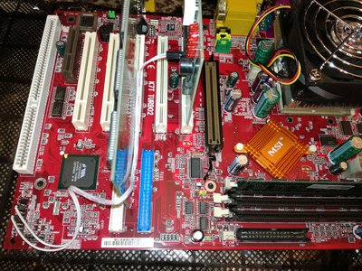

Well, SETBLASTER, thanks for the tip. My board arrived yesterday, modded today:
The attachment MSI_K7T_T2.jpg is no longer available
Don't know if it's due to the different colour scheme 😊 but for me the mod went smoothly. A big thumbs up for the ZD917 (de)soldering station, took me less than 1 hour to pull the slot from a dead board, clear the holes, install it on the MSI and changing 3 bloated caps. Used 2200uF instead of 2700 because that's what I had.
Tested with two ISA VGA, display was OK (but slow to draw even the BIOS tables) and two PnP soundcards, YMF719 and ES1868F respectively, that appeared correctly on the ISA PnP device listing. I haven't booted an OS yet, but the slot seems fully working so I don't expect any problems.
