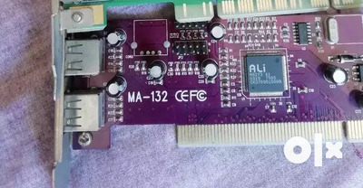

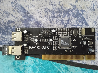

Reply 166 of 383, by ayandon
I use these two -
I want to restore my late father's 1st ever computer IBM ET&T PC-XT that he gifted me.
Hope you will be kind enough to guide and support me to restore his loving memory.

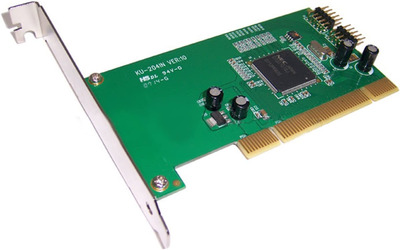

I found this one, and it works fine: https://www.amazon.com/gp/product/B004576JGI/ … 0?ie=UTF8&psc=1

I think that card pictured is using one of the chips that really slows the system down on socket 7 builds I have tried it on.
I like that internal header design though. That is handy for specific builds

What systems have you tested it on? It looks perfect but, as mentioned, it appears to use the same chip.
