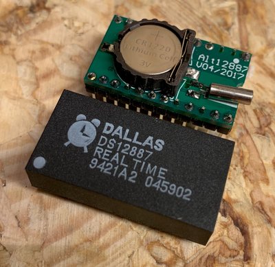

I decided against selling what I had even if I have a whole pile of them because shipping ends up being more expensive from here than the sale value of the assembled module itself and it seemed ridiculous to ask ~$20 shipping for a $15 item. My work unfortunately also keeps me offshore and out of internet range for extended periods, which makes the logistics of taking orders and shipping things complicated at the best of times.
It's why I made everything public on OSHPark here. For a bit of DIY. For ~$4.20 you get 3 PCBs. Procuring the other components is an exercise left to the builder. 😉
Batch orders of 5-10 or more might be more doable, as shipping becomes much more economical in bulk. As it stands, I have a dozen tested and ready but I will be offshore until mid-September.

Honestly these look so much better than Frankensteining an old RTC chip, and it bothers me having a dead battery attached to any electronics, regardless of how hermetically sealed it thinks it is. Good job 😀
And thank you for uploading the gerbers. I think I'll give PCB train a shout and give this a shot.

As a note, one of the only potential issues I can see coming up with the newer, non-castellated model that can use 'square pin' headers is that those pins might be too fat for the original chip holder or, if soldered to the motherboard, too fat for the pad holes in the motherboard PCB.

Yeah those are pretty much what the castellated version is meant for. It uses those headers 'stub side up' and the castellations are made wider to fit right around the wider cylindrical part of the pins. Of course, the non-castellated version will work just as well with those. 😁

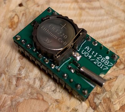

the 2oz copper is not necessary, that's for higher current applications.
Those aren't the right crystals; they would work in theory, but the contact spacing is likely wrong for the PCB. What you would be looking for are the common cylindrical kind, only with 'bent' pins;
It's pretty easy to get the 'straight pin' ones and bend them yourself too.

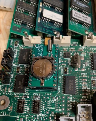

I just wanted to send out a big thank you to Maeslin for this design. I got my PCB from PCBway and the other stuff from ebay - and put it together in half an hour or so. Works perfectly on the first of two motherboards I wanted to fix!

Glad to hear it works well for you! Sorry for the delay, for some reason there had been no notification of a new reply.
If you haven't done so, I recommend securing the 32khz crystal case to the PCB with 1-2 drops of superglue. Makes it less likely to just yank the solder pads off if the crystal ever gets snagged by something.

I'm particularly fond of how the RTC's PCB colour matches the motherboard. Looks very natural.
