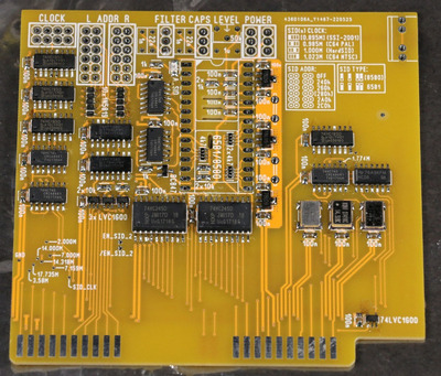

An update on debug block verification .
I've tested SID-containing one.
Basically, it works as intended:
https://www.youtube.com/watch?v=uJK9DpSWL8Y
It works with "SSI-2001 compatible" games. And it works with "*.SID" file players.
But it has heat problems when using with 8580 SID.
I have to look into that and, maybe, change a little power supply section. For example, I could drop 12 -> 5 V in two steps instead of one as I do now.
Now there is a single 78L05, that dissipates (12-5)*0.11 = 0.77 W of heat when working with 8580. And it has very small copper polygons to take that heat away.
I can drop that voltage in two stages: 12 -> 9 V and 9 -> 5 V, I already have 78L09 in the BOM. Total heat will be the same: (12-9)*0.11 = 0.33 W and (9-5)*0.11 = 0.44 W, but it can be spread out on two ICs. Also I can try to get more solid copper around those regulators.

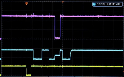

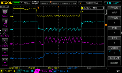

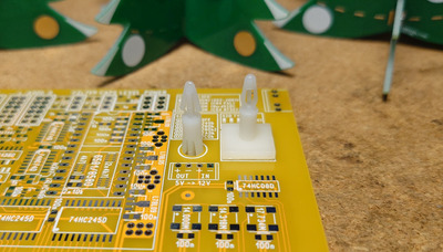

I've tested 2xSAA1099 debug block (Creative Music System compatible). It is based on Tronix's schematics with some changes.
https://youtu.be/WBGyWLHU8hI
The PCB is pretty old, it's 01 version from 2018. Of course there where some errors - I've forgot to connect /OE pin of 74HC245 data bus buffer and debug board prevented the system from POSTing. I've quickly found the error, added a bodge wire and system booted.
SAA1099s run pretty hot, on the 01 version PCB those were powered directly from ISA bus, but as test revealed it lead to excessive noise on the output, so I rewired SAAs power through a 7805 regulator with radiator that was getting pretty warm.
I've updated PCB project adding a 5V regulator for each SAA synth (regulators I use are 100 mA max, that's at the limit with one SAA) and big copper polygons for heatsinking.
Overall debug block worked ok, but with some problems. Major one - one of the synths was glitching. I had only two of those at the time, so I couldn't replace glitching one and proceeded with tests only on one synth (without some voices).
Most of the tests run fine, music plays, PCB gets detected in software that performs CMS detection via different methods, thanks to Tronix's research on that.
I've found some small errors in that schematic' though, but those didn't affect board's performance in any way.
Basically, I've minimized noise provided from ISA to SAA ICs and resolved bus conflict within the board itself. Those fixes didn't require any additional components, just some rewiring.

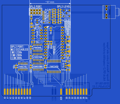

Reply 270 of 275, by Fagear

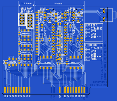

I've also had checked OPL2 debug block (AdLib-compatible).
I was very slow to begin testing this block, so PCB design changed several times before I've got to assemble one. So I've tested version 02.
https://youtu.be/A7bA6h1Hsso
YM3812 is purely digital IC, it does not output analog audio, it needs a DAC - YM3014B. Because of that OPL2 power was connected directly to ISA power lines but DAC was powered through 5V regulator. As a result output noise was less than noise floor of my audio capture, which was great.
The schematic is pretty simple and is not based directly on any other one. Synth IC, DAC connections from datasheet, output opamp from datasheet, data bus buffer (74HC245) is on every debug block, custom address decoder on two 74HC138 that allows different ports (including AdLib's 0x388).
57.16 KiB
4021 views
PC9.ReOPL2.02
To my surprise, the board just worked. No strange noises, no glitches. Every program and game just worked.
Except for one exception, in Ultima IV music was glitching, but I've found out that if I slowed down test machine (disabled Turbo) it was ok. I didn't have original AdLib or a clone card, so I could not compare, so I've assumed that it was sound driver error in that game.
Later I've found out that there is a patch for Ultima IV, that fixes problems with AdLib cards in fast PCs. I didn't test it, but I assume that it will fix problems with my board as well.
Synth itself and its DAC run cool.

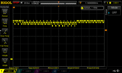

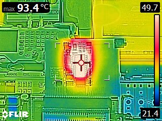

As long as debugging process was very uneventfull I decided to check a dozen of YM3812 ICs that I've bought from China. Most of thost had clearly visible signs of remarking, but that didn't affect their performance in any way.
But I've found some malfunctioning synths. To summarize, in every order from China there were 1-2 defective IC. Two of those produced lound click on start-up and were humming during music playback. But one chip was special... it was internally shorted and was rising in temperature very quickly when powered on. It could reach 100 degrees if left powered for a minute.
So I've decided to spice up my video and supplied that shorted IC with a little bit more voltage and current until it popped.
164.11 KiB
4021 views
YM3812 short circuit

In regards of further development of this debug block. I've already have doubled it (with shared power stages and address decoder) and I want to make an 2xYM3812 block for "stereo OPL2".
212.03 KiB
4021 views
PC9.ReOPL2.03

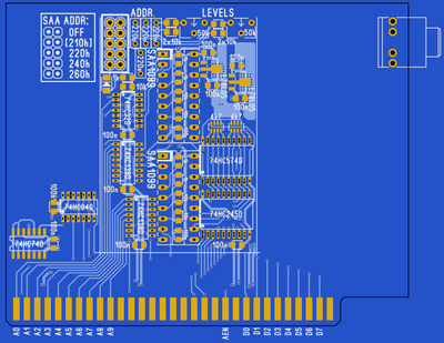

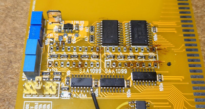

Hello, everyone. Time for long overdue update.
SN PSG block is technically finished (have to order last PCB revision for final inspection).
CMS (Creative Music System) SAA block was thoroughly tested and source of sound glitches was found: SAA1099 really doesn't like to get power from one power line and data referenced to the other.
After a little of brainstorming and testing, I've switched power source for both SAAs to direct +5V from ISA bus, removed one linear regulator and supplied power from the remaining regulator to output stage of SAAs (Iref pins).
224.26 KiB
1614 views
SAA1099 power debugging
No more glitches, no additional noise, less parts and heat output. Also I've returned low-pass filter onto the block itself because SAAs give out PWM output, that should be filtered first.

SAA1099 raw PWM output
So, technically CMS block is also done.

I've encountered a strange behaviour with AY-3-8910A, which caused system to crash when testing registers with my software. AY8930, YM2149, KC89C72 and even AVR-AY worked fine.
The problem with AY8910 was too low high-level output signal which caused 74HC245 buffer to oscillate and cause havok on the ISA bus.
26.27 KiB
1614 views
74HC245 oscillating
I've added pull-up on internal data bus of the AY blocks and that solved the problem.

SID block was also finished and I've also took the opportunity to test fit mounting hardware on that block.
391.41 KiB
1614 views
Mounting hardware
There is one thing: SID block also contains clock gen. I've used 74HC192 counters which were a legacy part from SSI-2001 replica project. You still can buy those ICs but those are pretty rare and not cheap.
Also while updating AY block I couldn't get a required divider with 74HC192s. This prompted me to search for a replacement and I've set on 74HC193s which are pretty silimar to 192s and can give me the required divider.
I've made a new divider circuit for SID block as well (192 was replaced by 193 to keep BOM in check), updated and assembled new AY and SID blocks. All worked well.

SID debug block (FMonster)
But one thing still bothered me: 74HC193s were still hard to find in stores. I've asked for help in my Discord and got a recommendation to use 74HC393s.
Those are pretty different, double binary counters in a slightly smaller case, but I've made some calculations and mockups and determined that I could replace all 74HC193s with 74HC393s.
I removed some 74HC74s (/2 and /4 dividers) on the way and put 74HC08s were I needed odd dividers. It all balanced out to be in roughly the same footprint, a little re-organized.
But now my design uses cheap and readily available 74HC393 counters. So AY and SID were redesigned again for that reason.
I've also updated DuoSID board with all new blocks.
OPN2 (Sega MD) block gives me headaches with high noise levels, low output levels and distorted sound. I need to go deeper with power supply of that synth. https://www.youtube.com/watch?v=2VuYXo-_DEk&t=574
OPL2 (Adlib) block was the single block that worked "out of the box" and gave me no problems. But that was the mono variant.
I want a stereo OPL2 block. And I don't want to mess around with jumpers all the time or hear mono only from the left channel.
Thanks to lazy designers of the PAS it is the problem, 'cause they used "mono OPL2" address as "left OPL2" address.
I've tried to come up with some clever logic that can detect access to the right OPL2 chip, but OPL2 has many registers, every software works differently with those, access order and frequency are all over the place.
I've even tried to monitor digital output for the DAC for the silence, but that had proven to be difficult with hard logic, no simple circuit can manage that.
So, at the moment, I've settled on combination of some logic plus RC delay circuit with the trigger. I have to see how that'll work yet. And RC time constant has to be tuned.
Basically, if there are any writes to "right OPL2" chip, circuit will automatically switch into "stereo" mode and will send 0x388 to the left IC and 0x38A to the right IC.
RC circuit will provide timeout function for those accesses for about ~1 s. Software usually polls OPL2 chip much more frequently even if nothing is changing.
When timeout expires, board will switch into "mono" mode and copy writes to 0x388 into both OPL2 ICs and also (later addition) it will copy output from the left OPL2 chip to the right channel as well.
Reads from 0x388 will still return data only from left OPL2 chip in any mode. And "Sound Blaster" accesses through 0x220/0x222 will always go to left/right chips with no mixing.
So I see jumper pack as:
- 0x388/0x38A (Adlib, PAS with auto-stereo)
- 0x220/0x222 (SB Pro)
- 0x240/0x242 (SB Pro)
First jumper can be set independently from second and third position. 2nd and 3rd are mutually exclusive.
So it will work sort of like my auto-stereo for DAC.
