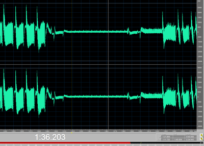

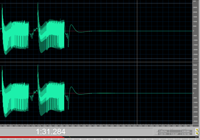

I've made some measurements and tested original board alongside with my replica.
Not good news for original board... As I've described some time ago, layout of the board is terrible. Measurements show noise (more like rumble and crackle) level is about -35 dB. 😲 When anything is active in the PC (CPU, RAM, etc.) noise level rises to -15 dB. 😵 You can notice this noise in the video above even when music is playing.
Also I've discovered that output of AY (about 1.0...1.5 Vpp) gets divided by 100! Right after AY output there are 100k:1k dividers for each channel right before "mixer" on a group of resistors. So... signal gets drown in noise and after that all resulting garbage gets heavily amplified in the final stage on LM386. Result is pretty awful. 😢 Insufficient voltage filtering on +12V (used to power opamps) and complete lack of such filtering on +5V rail (that powers AY directly) makes matters worse.
34.15 KiB
3527 views
CSM original: idle noise
After some thinking, cutting of traces and testing I've done the following:
- replaced crude "RC-filter" on the +12V rail with 78L09 linear +9V regulator;
- disconnected power supply of AY and 4066 switch from digital +5V, added 78L05 regulator from +9V rail and powered AY from it;
- temporary replaced 100k resistors in dividers with 2.2k ones.
The last one will have to be ajusted later, because signal from R2R DAC in the same mixer on the original board gets through 6.2k:1k divider (much less attenuation), but transistor amplifier on the original is powered from +5V and on my replica it is powered from +9V. So i have to level out differences between AY and DAC channels later (when I'll make my own R2R ladder).
All that gave me noise level about -60 dB. Not perfect yet, but pretty good. 😎
30.24 KiB
3527 views
CSM replica, power modified: idle noise
After that I've made recordings of original board and of my replica in the game Bad Blood and also I've recorded DuoSID in the same game on the same machine. DuoSID get lower than -70 dB of noise, which is great.

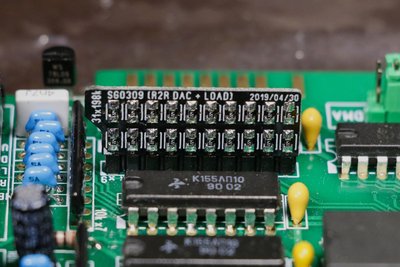

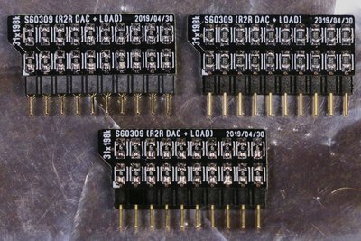

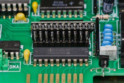

Reply 224 of 252, by Fagear

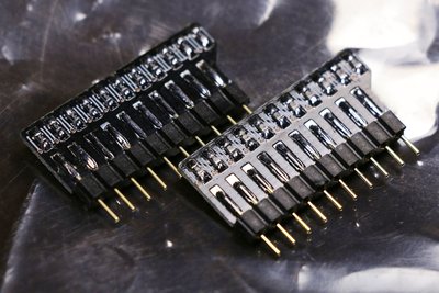

I've assembled a couple of R2R DACs. Resistors are not those ones that should be there, but it will be helpful for comparison with proper resistors.
1 MiB
3374 views
R2R DACs
686.82 KiB
3374 views
R2R DACs
787.71 KiB
3374 views
R2R DAC + CSM
760.39 KiB
3374 views
R2R DAC + CSM

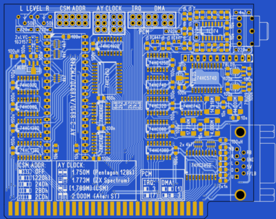

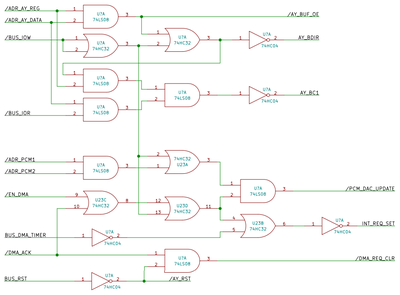

Reply 225 of 252, by Fagear
An update.
I've revised and updated GAL replacement logic and redid SMD layout from scratch. 😵
80.17 KiB
3151 views
CSM GAL replacement @2019-10-01
I've managed to remove a couple of ICs from the GAL replacement section and re-structure logic utilization between different parts of the board.
Also, at the moment I beleave that no software was using "4-bit volume control" feature, so I've removed diode-resistor DAC from AY's port A and corresponding LM13600 opamp.
I've left in place "mono switch" on output, but reconstructed analog output section a bit.
AY8930 (and YM2149) have internal frequency divider, that was used on the original board, giving 14.318M (from ISA) /4 (on D-triggers) = 3,58M /2 (on internal divider) = 1.78975M for AY.
But "the original" AY-3-8910 doesn't have that. So, I've decided to switch off internal divider and place an external one on another D-trigger.
Next, I've thought "what the heck, AY-chips of all kinds were used in many different machines, what frequency it was run in those?".
I've did some research and came up with the list:
  • 2.000 MHz = Atari ST
  • 1.7898 MHz = CSM
  • 1.7734 MHz = ZX Spectrum
  • 1.75 MHz = Pentagon 128k
  • 1.000 MHz = Amstrad CPC
Feel free to correct me if I'm wrong.
So... Keeping in mind FMonster project and its clock generation block I've managed to implement all those frequencies in new board. 🤣
Also I'm thinking about removing joystick ports from SMD-variant of the board. But I'll keep those in "proper" TH replica. 😕
On the screenshot below there are no:
  • PCM circuitry
  • analog mixing/filtering stage
  • clock generation unit
92.07 KiB
3151 views
CSM @2019-10-02
White thick line denotes fully completed "AY-only" block (no PCM, no DMA, no joysticks) ready to be put into FMonster.

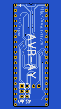

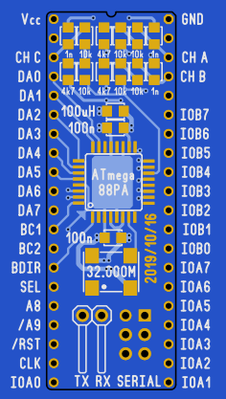

In the meantime I've made PCB for this:
11.58 KiB
3058 views
AVR-AY top
62.28 KiB
3058 views
AVR-AY bottom

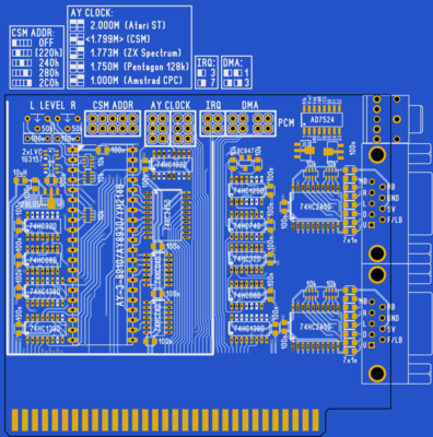

Reply 227 of 252, by Fagear
An update on CSM.
SMD variant is almost done.
110.26 KiB
2968 views
CSM @2019-11-07

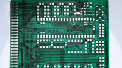

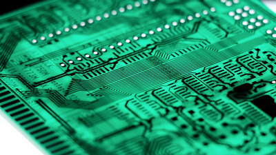

It's time to assemble new SMD variant!
New BIG soundcard: FMonster.
