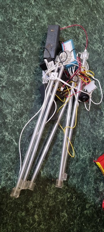

I just went to my mums place as i recall in her attic she had some old neons, like... those neons I'm sure we all remember. Blue cathode tube ones. Absolute classics which i used to put in everything. Sure enough i had a look and i found them. God knows if they work these are literally from 2004 - 2006 but if they do they are going in this machine!

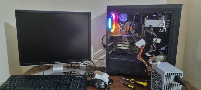

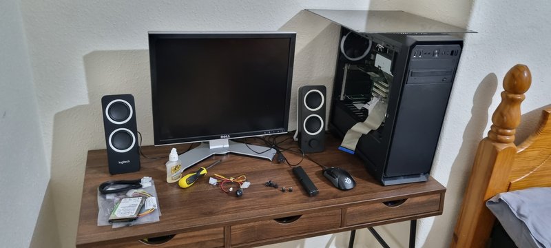

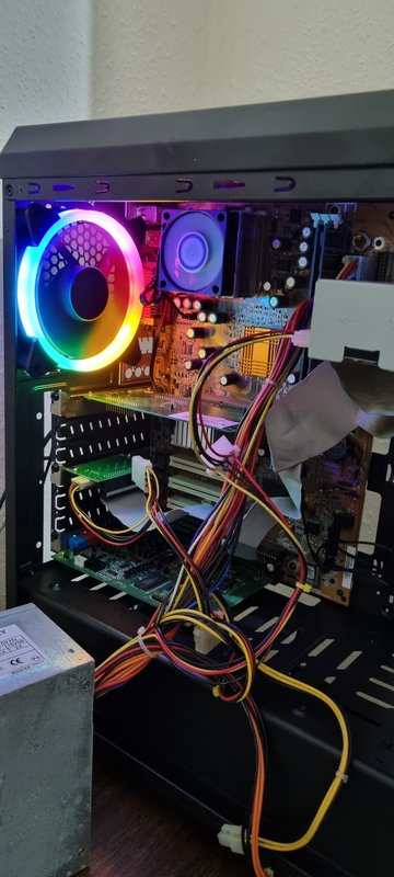

So as it stands i've now purchased everything i need to build it...
I've built a complete system for just under £140 which i feel is pretty good! I've replaced some items that came with the bundle as they are poor quality. Additional parts I've ordered:
FSP Group 250W ATX PSU £7
Verto Geforce FX 5200 AGP 128MB Graphics Card boxed - £6
Gelid Solutions Silent 6 Quiet CPU Fan - £6
Microsoft Wired Keyboard 600 - £5
Creative Labs Sound Blaster LIVE! (SB 16 compatible model) - £12
Afew cables for fans/extensions which i will need for the case choice - £15?
New PC case - £28
Now the case choice might be questionable... it sure as hell doesn't fit the machine inside but it was new and cheap. All the retro cases are £100+ for some reason... so stupid. But this is what i went with...
It was the only thing i could find with a CD drive bay, window and full ATX which doesn't cost a fortune. I would love a retro case but they are all stupid money. This will do the job though i guess.
On another note... The neons still work after 15+years in storage 😀

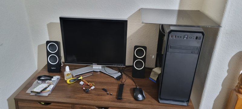

Reply 6 of 24, by WarhammerDarkOmen
Well it's been progressing... I've partially built the machine and its coming a long well. The modern case doesn't look too bad i think either.
Currently its:
Aopen AK77-400GN Motherboard
AMD Athlon XP 2400+
2x 256MB DDR400 RAM
Sparkle TNT2 M64 Video card
Pioneer DVD-RW
16GB Sandisk CF card via IDE
I did spot this and it was only £15
it's untested but worth a gamble as i found an AWE64 i had from years ago and this bundle would be better than my current one i think, certainly would for DOS. It's a 800Mhz athlon, 256mb SD RAM and i believe PCChips motherboard. If it works, will make a better setup for Win9x / DOS i think and it could even be the start of a dedicated MS DOS pc. Well shall see.

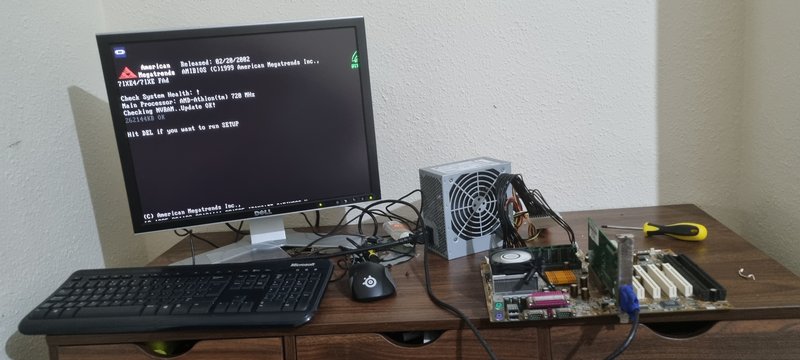

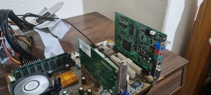

So after lots and lots of tinkering i got the older board to boot up and good job as the newer board has leaking caps so its really unstable, will recap it another day but for now I went with this.
It's actually a Gigabyte GA-7IXE4 and it was being a real pain to get going. First time trying it fired right up and no issues but after awhile especially after turning it off fully the machine wont POST.
I did get round to trying my game of choice, Warhammer Dark Omen and it runs perfectly with full 3D on the TNT2 card
It's not super super smooth but i'd guess around 48 - 52 fps? I haven't really tweaked many things yet and im lacking chipset drivers. But maybe this is just how the TNT2 cards are im not familiar with them.
I've got this to go in it next, an AWE64 I'm not even going to bother with the Sound Blaster Live! on this.

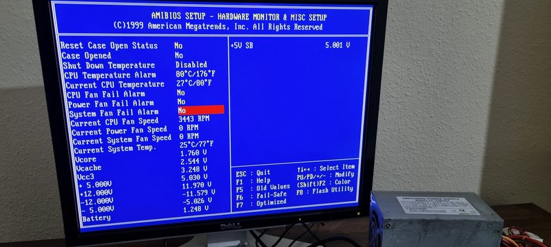

I've chucked it all in the case now, and it refuses to POST... two times now i have put it in the case and it won't POST. It's either coincidence or the PSU as I've checked literally everything for any possible shorts etc.
This is where im at now... waiting on the new PSU
I did check in the BIOS and the voltages on the 12v rail were dropping to 11.7 or 11.6v at times, this is a old PSU and looks like its been in damp storage so i will try it with the new one asap.

I've been having a hell of a time with this machine. The new PSU came but it still refuses to boot any time it's inside that case??? Outside it works, perfectly but inside it I get absolutely nothing I've checked all over for shorts or anything like that or if the stand offs are not sitting right but nope... It's nothing obvious. Any ideas???
It's so strange, but anyway im carrying on without a case till i can work that out,
My first time using an ISA sound card again since the 90's!
It works great, just need a case.. that works! 😒

Could it be a problem with the power button in that new case? Try shorting the two pins on the front panel header to start it rather than using the button. Along the same train of thought, try disconnecting all the front panel LEDs/speaker/IO as well.
Edit: just realised it's powered on in your picture, obviously not the power button at fault then
Reply 18 of 24, by WarhammerDarkOmen
Shadzilla wrote on 2023-12-04, 19:23:
yeah it turns on but no POST its really strange.
I've tried:
Looking for shorts or metal touching the board at all, anywhere
Unplugging things bit by bit till its literally just board and PSU
Unplugging all the front panel buttons etc and using a screw driver on the power pins
RAM sticks
I've now bought a replacement case. £15 + £6 shipping its a Zalman one with a little window so will be fine for this.

Reply 19 of 24, by Shadzilla
That's really bizarre. What about the rear I/O shield, could that be shorting on anything?
