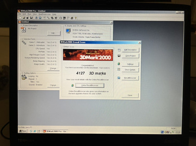

How you managed to get here 5000+ marks?)
Re: Toshiba 2805-s402 Ultimate retro gaming laptop
I only have 4100.
The attachment 25A1752B-4302-44C3-8D69-403A7CCD7C0E.jpeg is no longer available
Reply 82 of 168, by vorob
I’ve tried the same benchmark on my other unit and I got the same score, 1000 less than you have. Maybe you overclocked GPU or used another driver? Or lowered settings?
Reply 83 of 168, by Warlord
don't remember, probably lowered settings, to 800x600 or 640x480. But that was on the 800mhz cpu version, so try that and your scores should be higher. Was on the 12.xx driver.

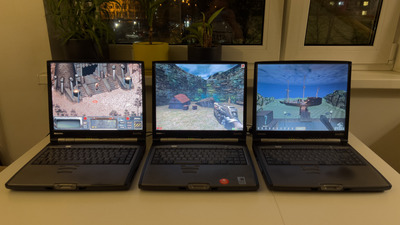

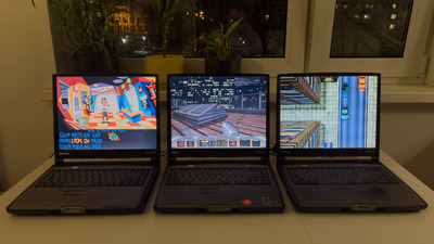

Gathered my three friends 😀

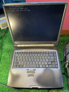

I also managed to get one of these 😀 It's a Satellite 2800-S500 and definitely has the GF2go in it. Actually it was bought without me knowing what the full model was, I could only tell it was a Satellite 2800.
The attachment ebay1.jpg is no longer available
But the wear on the palm rest gives it away, along with the good display scaling.
It works actually quite well after dismantling it entirely & cleaning it up. It had the same hinge trouble that everyone else has had.
Thankfully I was able to fix that by removing the hinges entirely, putting them in a vice then working the hinge while flushing it with PTFE spray lubricant. It took a while (the full disassembly required sucks) but eventually they freed up.
Now both the hinges are working well, holding up the display and opening without cracking / giving too much resistance.
The cast metal that connects the hinge into the rest of the palm-rest had cracked though, I used some thin steel sheet to try to rebuild them a bit. Seems solid enough for careful use.
The keyboards are pretty easy to get, since it's shared with the Tecra 8100 / 8200. So now mine has all the keys + a clean keyboard.
The only thing that lets it down now is the speakers in the palm rest seem to be damaged, the right one distorts pretty badly.

What these six games are?
Cheers,
Great Northern aka Canada.
Reply 87 of 168, by vorob
DOS: Day of the Tentacle, Duke Nukem 3D, GTA 1
Win: Fallout 2, Unreal, Thief II

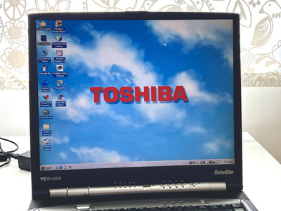

It works! Thanks once again 😀

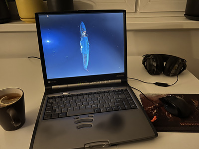

p.s. currently playing Homeworld on this beast 😍
