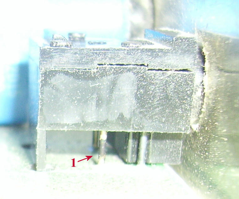

Reply 84 of 85, by h-a-l-9000
Rank DOSBox Author
DOSBox Author
Or better: first try to push it down so the gap closes, and check if it works now.
1+1=10
Reply 85 of 85, by retro games 100
Solved! Thanks a million, h-a-l-9000! 😀 That worked. I can now listen to funky Adlib tunes on this 22 year old sound card!
