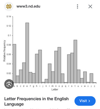

Reply 63 of 67, by rmay635703
Harry Potter wrote on 2025-02-27, 00:24:
I took a better look at PrintTok2's output earlier today and confirmed that the tokens gathered in Pass 1 are realistic, but, after sort, I'm getting very few tokens. 🙁 Every tweak I applied to the sort function, even when they gave more tokens, cost me in overall compressibility. I really don't know what's wrong with the function.
If you had already designed your text adventure along with all the words that you used you would be able to experiment and generate a table like this that would cover how often various characters or words were used
The attachment IMG_6363.jpeg is no longer available
A method of using less space under specific circumstances would be to limit your character table to 4 bits with the 16th character being an escape to others. This approach only saves space if you use automatic capitalization and punctuation along with a limited character set where certain characters are heavily favored and symbols and numerics aren’t used.
Natural language is very favorable to this but game language may have a different distribution.
The only way to get the absolute smallest file size is to have a completed game and then to apply a “bespoke” elegant solution to your specific dataset.
Generic solutions are more of a modern solution to large datasets.
Vintage games that fit on a 5 1/4 floppy needed to be creative if they had an immense wall of text.
It is hard to beat uncompressed 5 bit text packed three to a 16 bit word with a flag if your text is varied and non-repetitive.
The more immense your game is the more complex compression methods can become while still saving space. The complex methods don’t work on a short simple repetitive game.
