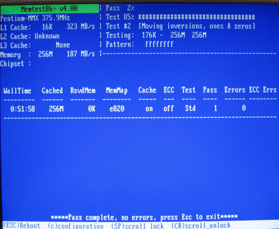

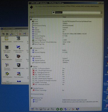

For some possible CPU-frequencies tested (changing of the CPU-ratio for having 225 to 375 MHz, according to the increased FSB of 37,5 MHz), AND for measurements at the shown bottom-pins AS WELL at the voltage-generator itself (AME1084), the Vcore is always 2,9 Volt! Constantly!

1. It seems to be so, that at least some GX1-chips still accept the "old" higher voltage (2,9 V) of the GXm-generation (similar to my experience with the Cx6x86L shown in this thread, as I was able to run it like the 6x86-non-L stable at 3,5 Vcore instead of 2,8 Vcore). This is maybe similar to some CPUs AMD-486-DX5-133 accepting 5,0 V instead of 3,45 V (and so they are able to reach 200 MHz).
2. Why my CPU can run at 375 MHz (due to the higher voltage).
