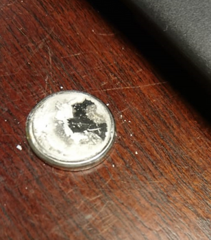

Reply 241 of 436, by edumoes
Searching for "sc-55 battery", google shows this post.
And guess?. Yes, i've brought a SC-55 some days ago, same situation.
CR2032 full of white "acid killer". Just cleaned up a little of the holder/board with Vinegar / isopropilic alcohol.
The attachment sc55-1.png is no longer available
The attachment sc55-2.jpeg is no longer available
Reply 242 of 436, by bjwil1991
You're very lucky, man. Good thing I changed the battery on the old SC-55 before I sold it.
Reply 243 of 436, by Dax
Thanks for the heads up. I checked mine out and the battery seemed fine, but I decided to replace it anyway.

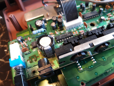

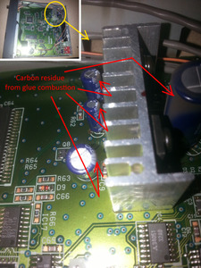

blackmasked wrote on 2017-05-05, 17:48:
I own SC-55mkII and have had no issues with the battery. Instead I came across this when I opend it up recently. IMG_7747.JPG […]
I cleaned it up as well as I could, replaced the cap and so far so good.
Quality cap, but that didn't stop it from failing. 🙁
Dredging up this old issue again.
I found an identical situation inside my SC-55. But I further speculate, based on the evidence of certain scorch marks inside my unit, that this glue has actually combusted at some point in the unit's history. How dramatic, I know!! The scorch marks ("soot", or carbon residue) are present on the casing ceiling above the nearby heatsink region, and crucially, that black carbon residue are also present fully up one side of all 4 capacitors which are next to the heatsink.
The point being, soot does not occur merely by "gently warming up" a thing - actual combustion has to have occurred. The crusty, brown, bubbly (bubbly = it has boiled) nature of the residue at the capacitor base further supports that speculation.
Therefore I believe this is what happened, in sequence :
1. The heatsink heated up - perhaps in conjunction with heightened power draw scenario, and/or living in a hot country or room
2. This factory 'glue' has melted off from the adjacent capacitors, which are only millimetres from the heatsink
3. Gravity caused the melted glue to form a puddle at base of capacitor
4. Combination of heat, combustible glue fumes, and possibly even electrical short has ignited that puddle - likely a quick, 'split-second' flare up, there-then-gone.
5. Causing black scorch mark above heatsink on case, and black scorch marks up the sides of the capacitors, and leaving hardened, bubbly brown crust of burned glue at base of the capacitor.
This does not seem to have affected the unit's long term operation, though the capacitors' effective lifetimes were perhaps marginally reduced by the treatment.
Something to keep an eye out for, inside your units. For curiosity's sake, at least.

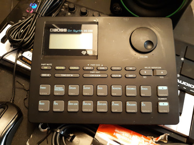

After 24 years, I bought another Boss DS-330. And I lucked up and got the 2nd revision like the one I used to have (GM and GS instruments plus the GS logo on the screen next to the GM logo). The problem, the seller said the battery was shot and it won't power on. I was all but asleep when I hit the "buy it now" button on Ebay and didn't discover that I had bought it until a day or so later. So I'm going to crack it open later today to see what all has happened to this thing and hopefully I can bring it back to life and use it in ways I didn't know was possible when I had my old one.

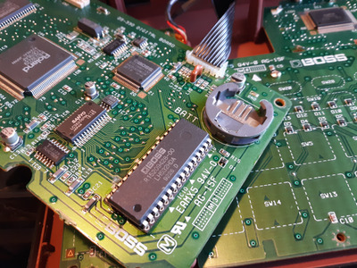

So I got the DS-330 apart and they weren't kidding... The battery's gone. So are a lot of the screws. This thing's been opened a few times over the years.
The attachment 20210207_153710.jpg is no longer available
Ordered a bunch of CR2032's from Amazon. It claims they'll be here tomorrow. I also ordered a replacement for the Boss BRA-120 PSU which will show up later in the week.

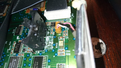

I'm reeeeeeally hoping this isn't what I think it is... It's no good when it looks like a cap is leaking. Thankfully, I'm handy with a soldering iron and there are plenty of places I can order caps from. I'm hoping I don't have to replace it.
Is that apparent leakage hard/solidified ? Could it be some kind of epoxy resin instead of capacitor juice ?
Reply 252 of 436, by imi
that definitely looks like glue, if it were a leaked capacitor it would be corroded around that area.
Reply 253 of 436, by misterjones
imi wrote on 2021-02-08, 02:30:
That's what I'm hoping. I don't particularly mind replacing a cap if it's necessary but I'm hoping that it's not.

Reply 256 of 436, by misterjones

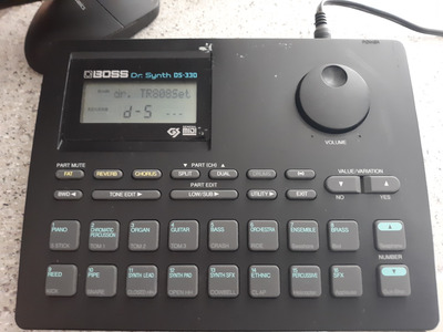

Replaced the battery on the DS-330. Received the PSU for it and fired it up and it appears to be working just fine. Now if only I could find some screws for it...

Reply 257 of 436, by Bancho
misterjones wrote on 2021-02-12, 11:16:
I just picked up one of these the other day for £30. Boxed with Manual, Midi cable and Boss PSU. Tested it working, and was getting the low battery warning. Whipped it open straight away and the battery was crusty. Cleaned the holder and put a new battery in. Works great.
