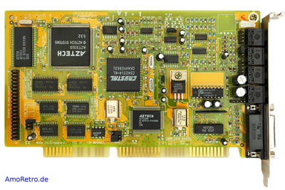

pitchshifter wrote on 2024-03-20, 13:32:
AZT3310, rebranded Samsung KS0164.
AZT3320 is the rebranded KS0164 (using AZT3321 sample ROM chip), both are 100pin chip rather than the huge 160pin one that is AZT3310 (alongside AZT3311 sample ROM). Both AZT3320 and KS0164 are found on identical PCBs.
AZT3310 is interesting though, the cards I see have two 8KB RAM chips next to the big chip. This possibly means it has reverb or even chorus effects since this is what one needs, what I presume to be, effects memory for. At least one chip could also be data memory for an internal CPU that does MIDI to music processing... I don't have such a card to take any closer looks however.
Reply 21 of 23, by pitchshifter
Exacty like this one.
Tiido wrote on 2024-03-21, 00:15:
